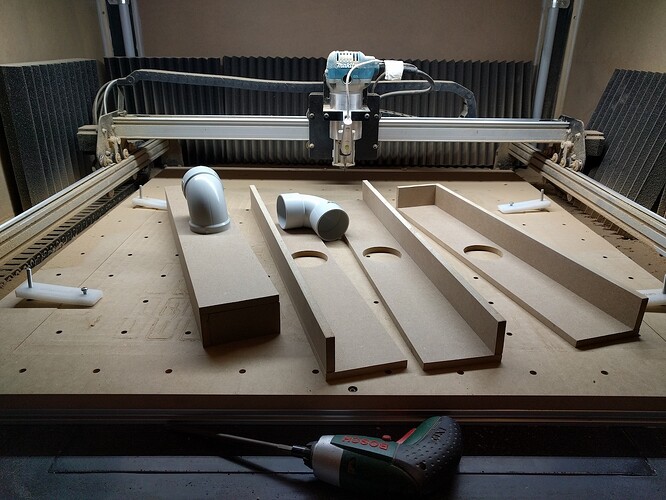

The wasteboard and extrusion supports will be removed and a piece of 18mm MDF will drop in. The piece of 18mm MDF can either have templates cut or I was going to make a universal vice style attachment for one offs.
These are really rough but I hope enough to explain. I will make a universal clamp in one of the templates. Kind of like a drill press clamp with some threaded rod.
The other templates will fit item exactly and allow them to drop down past the standard waste board height.

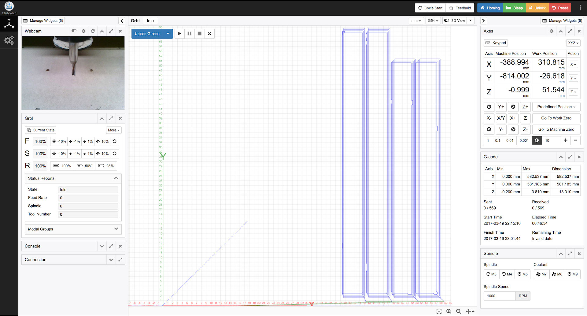

Works well for me. I had an issue with the Webcam being the wrong way, within 5 hours of submitting a feature request the developer had implemented a commit adding rotate and flip buttons.
