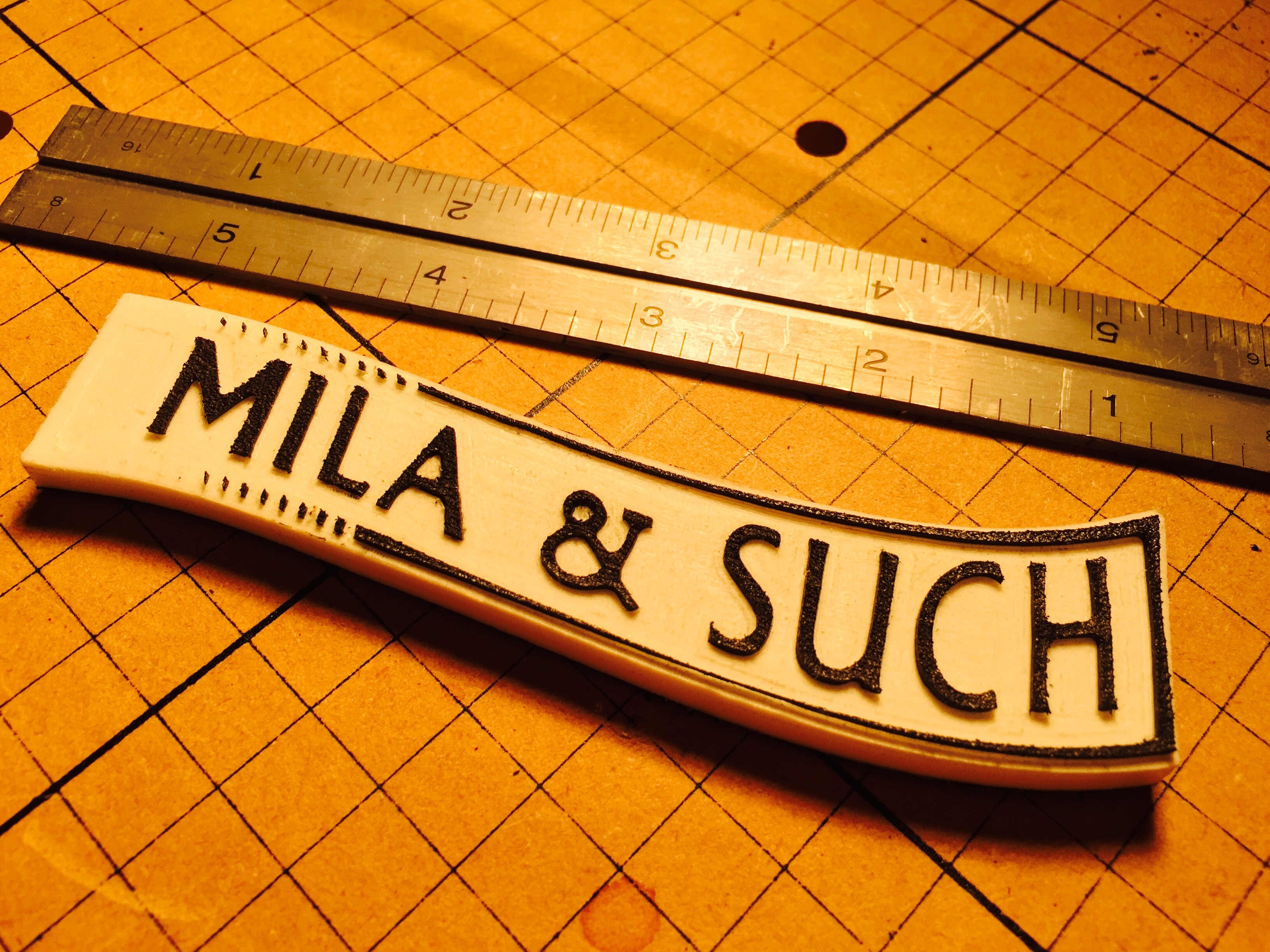

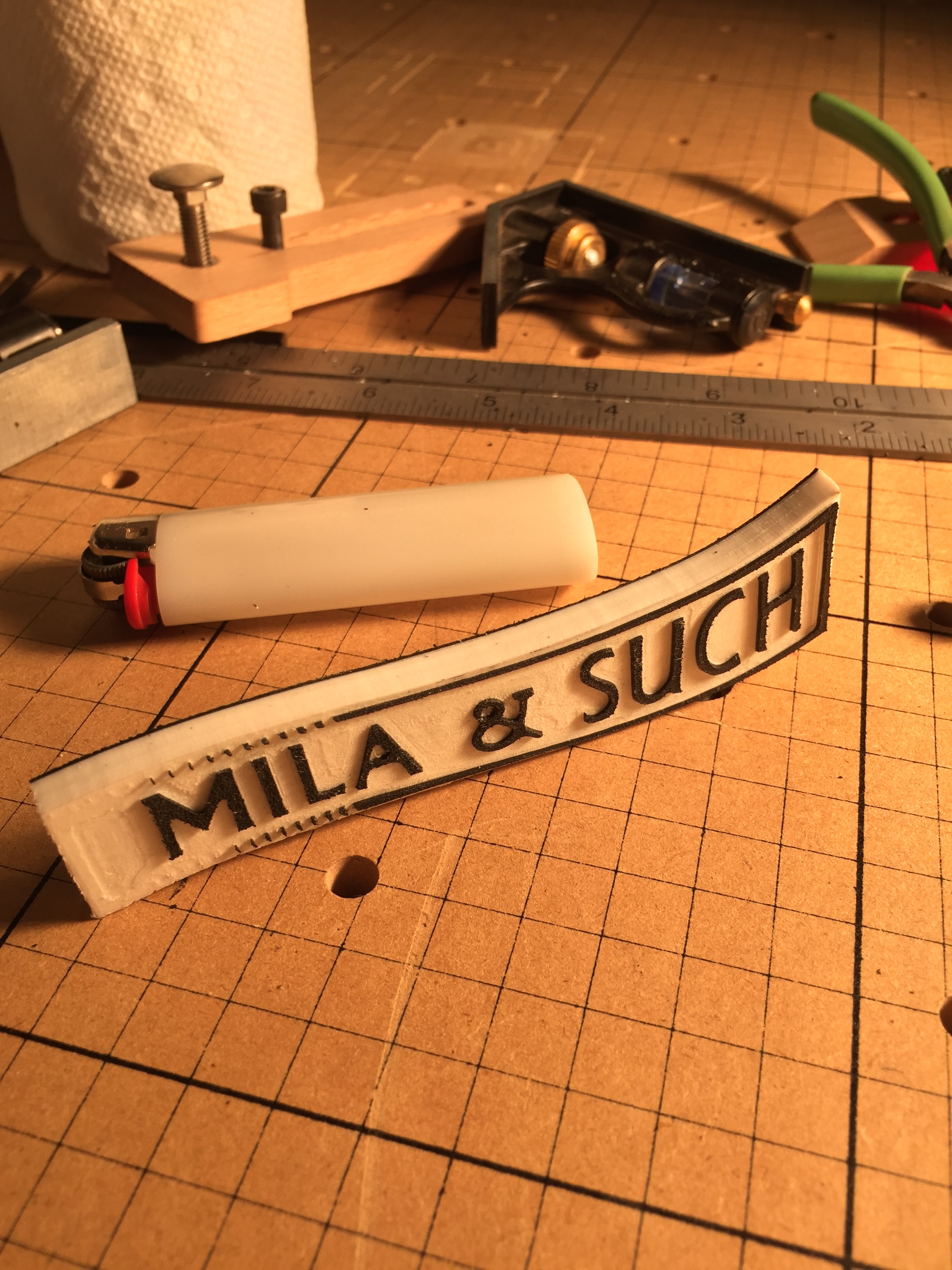

My first (and only) 1/32" carve SUCCESS… and broken bit
They said they were fragile. They are. I snapped it right before by second carve in 3 layer HDPE. It was my first carve with the bit. Dang. I thought I’d move it on my own, with the z kinda set and… tink*!
I’ll order many more tomorrow, and hopefully never make the same mistake again.
Here it is:

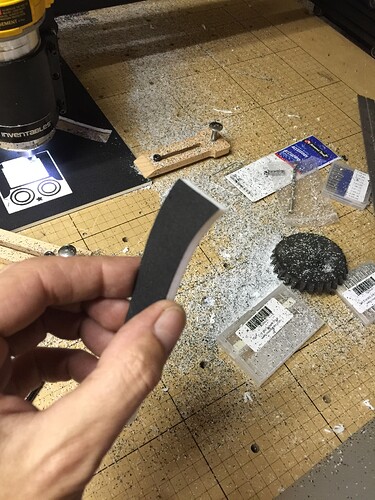

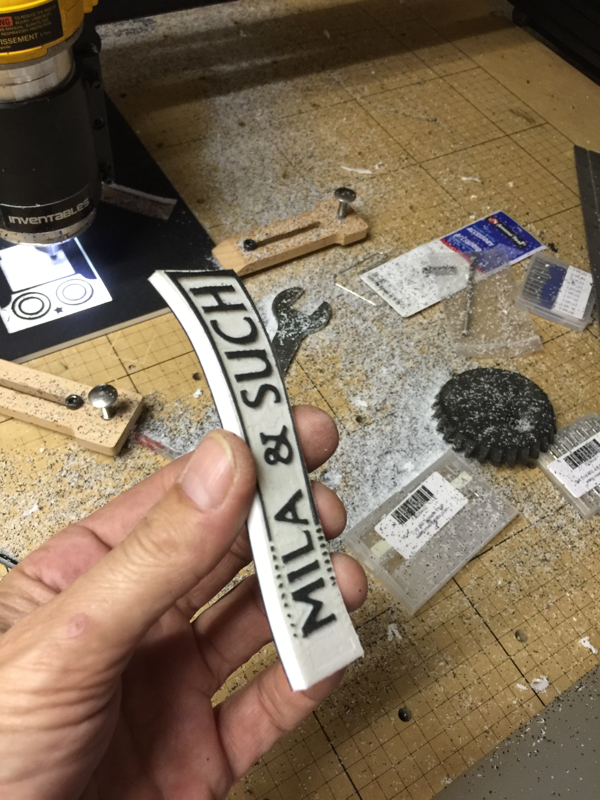

I couldn’t figure out how to clean up the furry black layer with this shallow carve, but I finally did with a wire brush, paper towels, iso, and a clean flame.
Next time will be faster. It may be a keychain… a promo. Dunno.
Thanks for taking a look!
