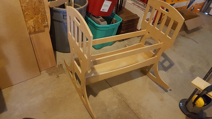

Hi! I don’t share a lot but I hear it’s a good thing. So I’m sharing a project that I made almost entirely on my 1000x1000mm xcarve out of MDF.
My wife and I are expecting a baby boy in January (she will probably destroy my xcarve if she knew I gave away the gender). So I designed this crib in Fusion 360 and cut out all the parts with my xcarve. Enjoy!

AustinSt.Aubin, sure, I can share the plans. You can find them here:
Note that it’s designed for a 15"x30" mattress.
Please note however, for anyone who attempts to undertake this project, that although I have done my due diligence to the max and ensured that all joints and connections are far stronger than you’ll ever need, I cannot be held responsible should anything go wrong during regular usage. You are responsible for ensuring that it is assembled properly and able to withstand regular use. Make sure you use wood glue for all joints to compensate for screws going into end grain. That being said, I’m very confident this would easily support my entire weight (although I haven’t tried). And I’m almost 200 pounds. Good luck!

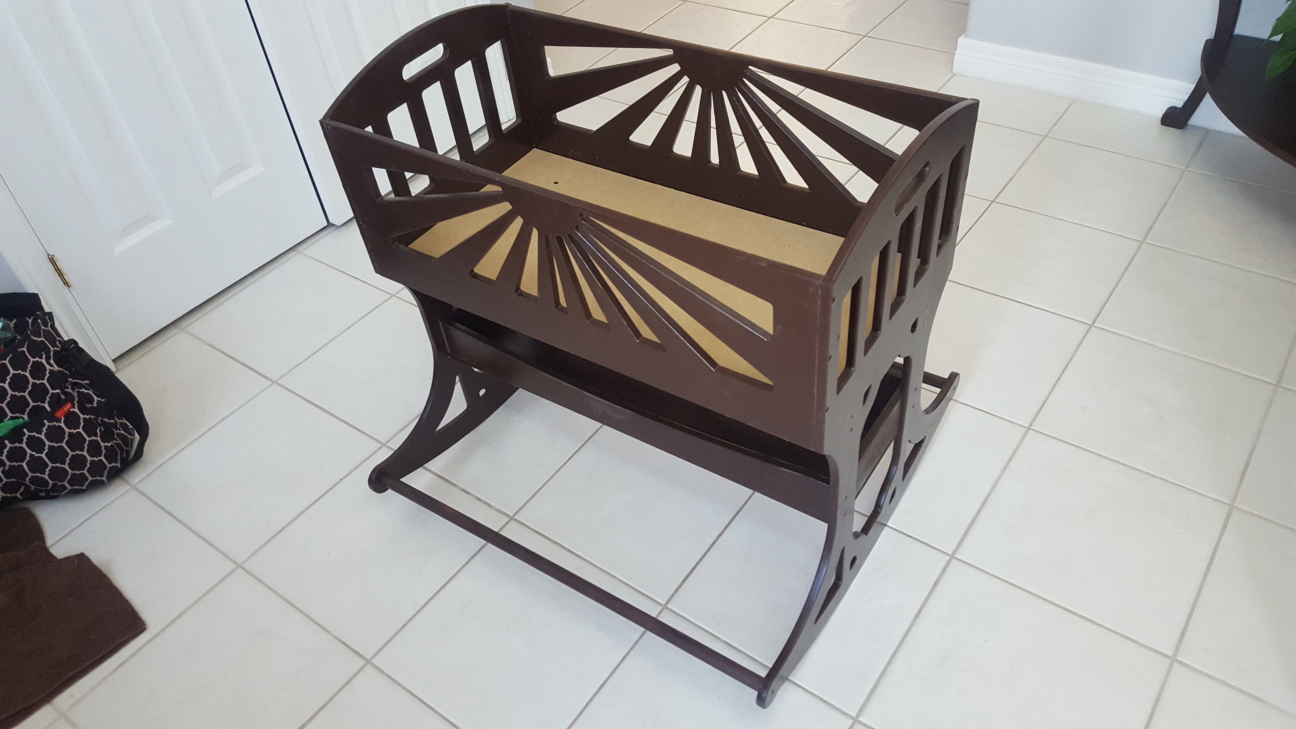

I don’t use mdf that much but I often find it a pain when sealing/painting the exposed edges (end grain, if you will)
Any tips on how you did yours?

TimMoran, sanding and painting the edges is truly a pain in the butt. What I did was use use my finger to rub drywall compound on all the edges. Once dried, I sanded them, then painted them along with the rest of the project. Time consuming but I don’t know of an easier way… If anyone else does, please enlighten us.
