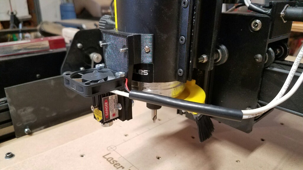

My J Tech Laser install on the X-Carve
I installed the J Tech laser on X-Carve. I wanted to have the laser in front of the spindle and easily removable. I 3d printed the parts and embedded some magnets and pins to hold it in place see pictures.

Nice job on the plug mount! I like it!
What dust boot are you using?
The dust boot is my design and 3d printed
Now I need a 3D printer. :grinning:
Is your dustboot file available to print or are you selling them at all?
Not at this time
