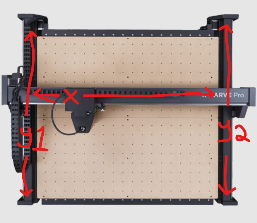

Front to back (the 2 motors working together direction of movement) would be the Y axis.
However your description sounds as though there may be loose wires. I suggest checking all connections including unplugging the white connectors on the stepper and checking for damaged pins there as well, as these tend to get loose over time then wiggle and start to burn/char the pins…
