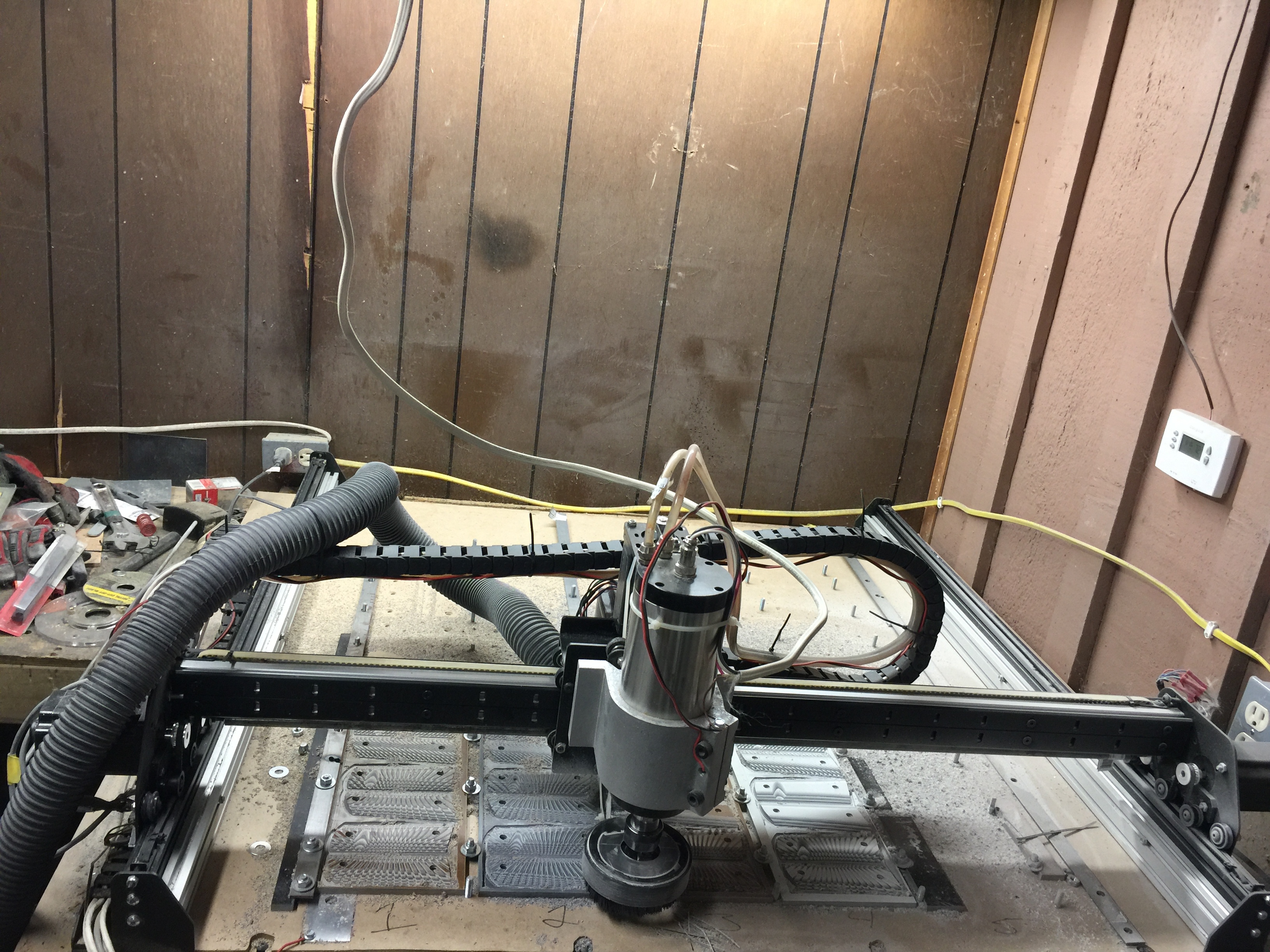

I went a different route with my stiffness upgrades than most. First, my X-axis I completely replaced with a 40x40mm extrusion. I bought some V-rails from Openbuilds that bolt onto the the extrusion. When i did this, there is a 4mm difference from the standard makerslide setup. I used 4mm shims on the front 4 V-wheels to make up the difference. This has been a pretty solid upgrade!!
Next bought some 40x20x1000mm extrusions and bolted them to the Y-axis makerslides. I found without this, the Y-axis shakes a lot. This completely fixed this problem. I used self taping screws to attach the extrusion to the makerslides.
The next issue I had with the X-Carve, was there is nothing physically connecting the two Y-axis motors. I had a Romaxx CNC prior to this and one of the important features was it had both of the Y-axis pulleys connected with a rod. I designed and printed a bracket to house two bearings just below the X-Axis extrusion and connected the two pulleys with a 1/4" rod. This keeps the two sides square even if one of the motor misses a step.
I upgraded the belts to GT3 because the GT2’s kept skipping. So far I like the machine for the price, but it definitely needed some upgrades for it to be usable for me.

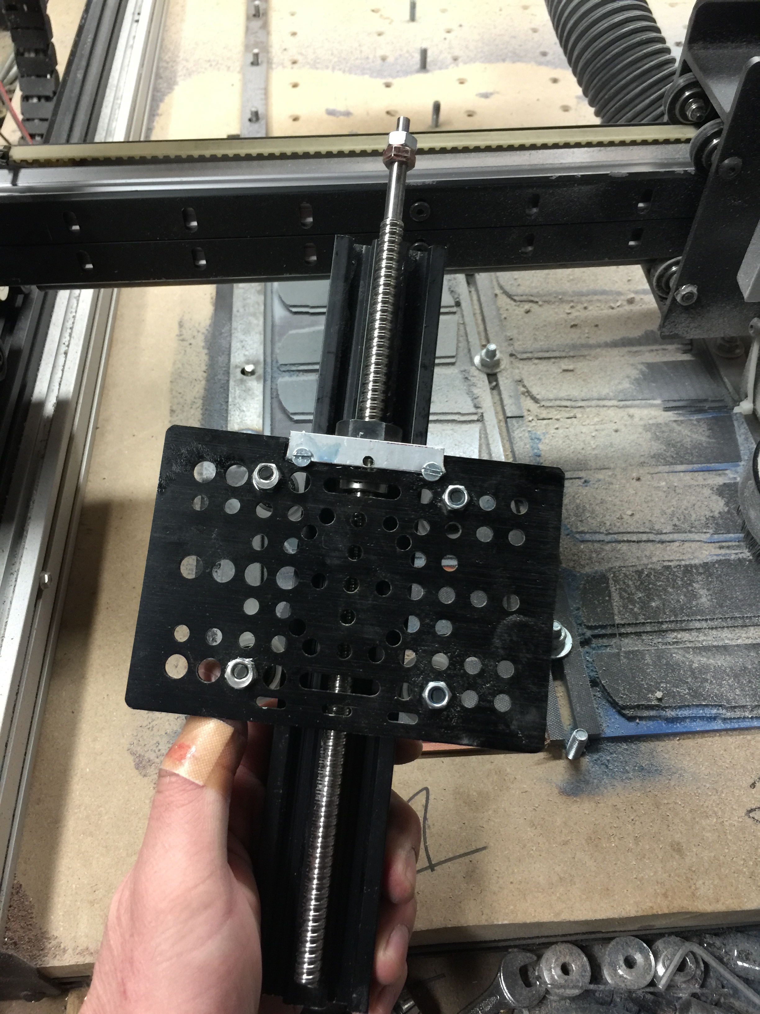

I also plan to upgrade the Z-axis to a ball screw.

So, the pulley connector… I bought a .25" steel rod from Menards along the smallest diameter steel tube they had. I don’t remember the size off the top of my head, but the .25 inch rod didn’t fit snugly into the tube, so I had to print adapters that slide into the ends of the tube. Without the tube, the .25 bar flexes too much then the belts are tightened.
to hold the bar onto the gantry I designed a bearing holder that attaches to the stepper motor mounts and is supported the idler spacers. You will also need to buy some bearings, GT2 pulleys and idlers (I bought hem from inventables).
The bar gets cut to fit between the two gantrys and you have to take off one side to get the bar under the X-carriage. Then, in order to re-route the belt, you have to add an Idler to the rear V-wheel. You will need a longer screw.
Once you get it all together, Tighten one of the of the GT2 pulleys to the rod and make sure it id against the bearing. Next make sure both side of the gantry are square and tighten the other side. Now both sides are mechanically connected!

Got a start on my Z-axis upgrade. I’m using solid v-wheels and a ball screw for smoother motion. I’m hoping to have it installed tomorrow.

Here is the finished Z-axis. Its pretty solid!!
