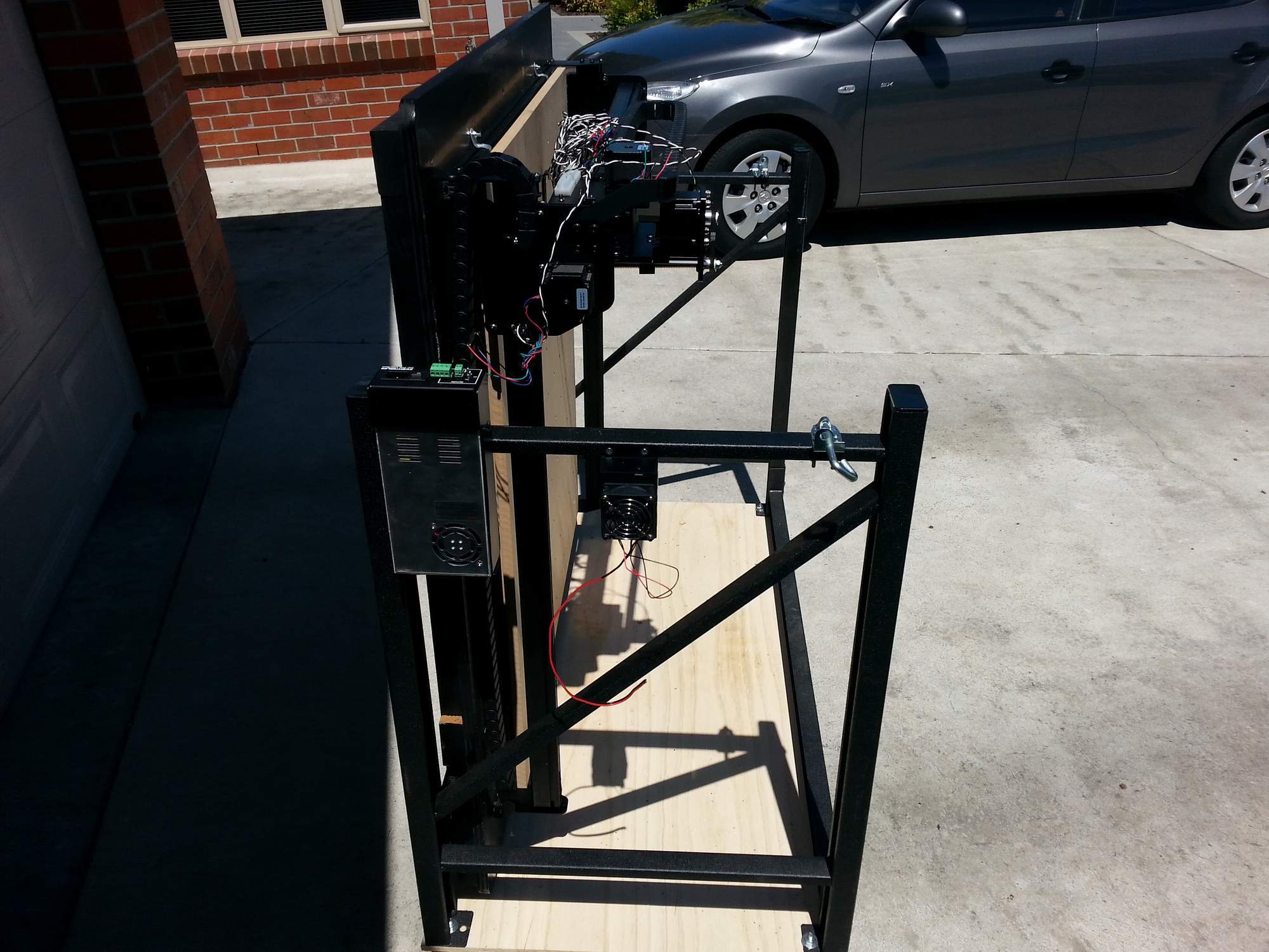

Looks good. You may also want to think about where you’ll place the power supply and electronics, as you’ll not want them sitting on the table top.
For mine, I put all the electronics into a sealed enclosure (it still has a cooling fan which pulls air through a foam filter) which is mounted to the side. The power supply is also mounted to the side, facing upwards allowing quick access to the power switch.
I’ll post some images if I can get to a PC…

It’s possibly a little overbuilt, but it’s pretty robust. All the cables are clipped against the table so there’s nothing pulling on the connectors & the enclosure has a bunch of holes drilled in the back & covered with dust foam.
Everything is available from Jaycar or Altronics. The table I considered building, but instead I bought from Ikea (for basically what I’d have paid for the wood alone). It’s a 1200x1200x950H “bar” table, to which I added a few drawers, trays and fitted with locking wheels.

Thanks for your suggestion and pics for the power supply mount. I borrowed some of your ideas.
