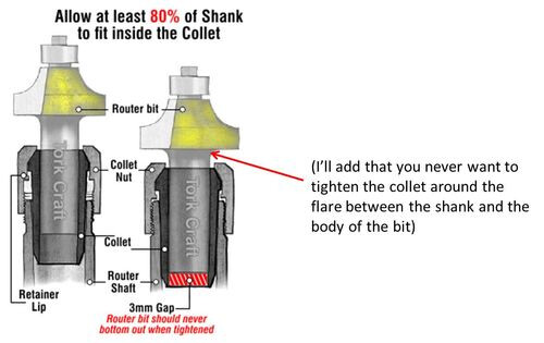

02:37 Bit stickout is way too much for that size shank bit. Be careful because the collet will not tighten properly without more inserted into the collet…

I always check to make sure and there was part of the shank going past the top of the collet insert… but could always put more in per your included image so thanks for that.
