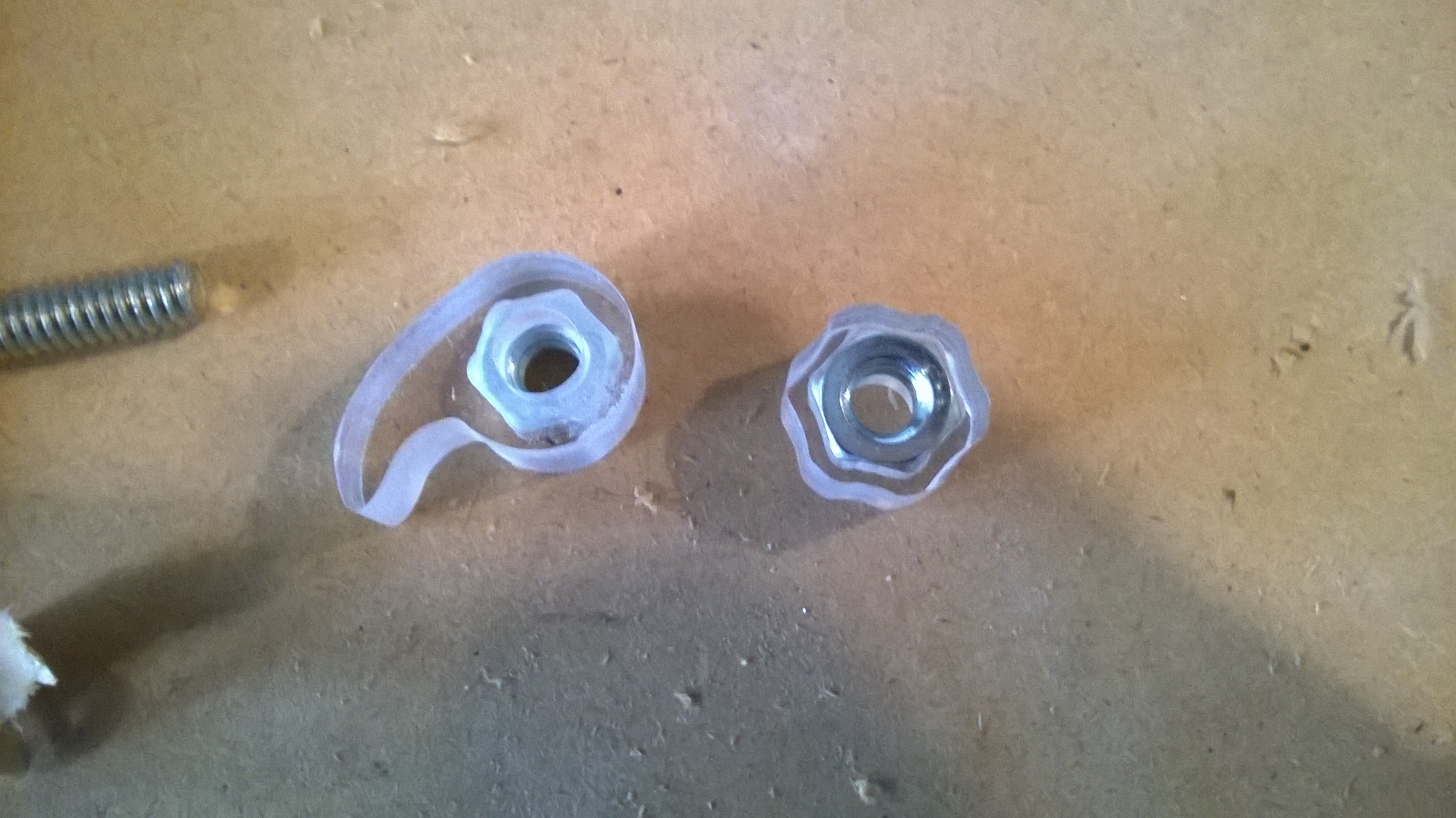

Pulling inspiration from phill’s design and the suckit, I am making my dust boot.
I wanted it to be a single sided cut and require no drilling into the machine.
In order to make this a single sided cut, I opted for using 1/4 hex bolts and a t-track that is compatible with them. This way, after carving, I just need to bore a couple of holes and tap one.
I cut the acrylic parts and everything went pretty well. snapped a bit at the start due to overlooked settings, but after that it was smooth sailing. took 2 hours roughly with a single flute 1/8 upcut spiral. 85ipm except for the pocketing which I had forgotten to change from 95ipm. DOC .02
There is something enchanting about cutting parts out of acrylic. I particularly love my 1/4" nut leavers.
