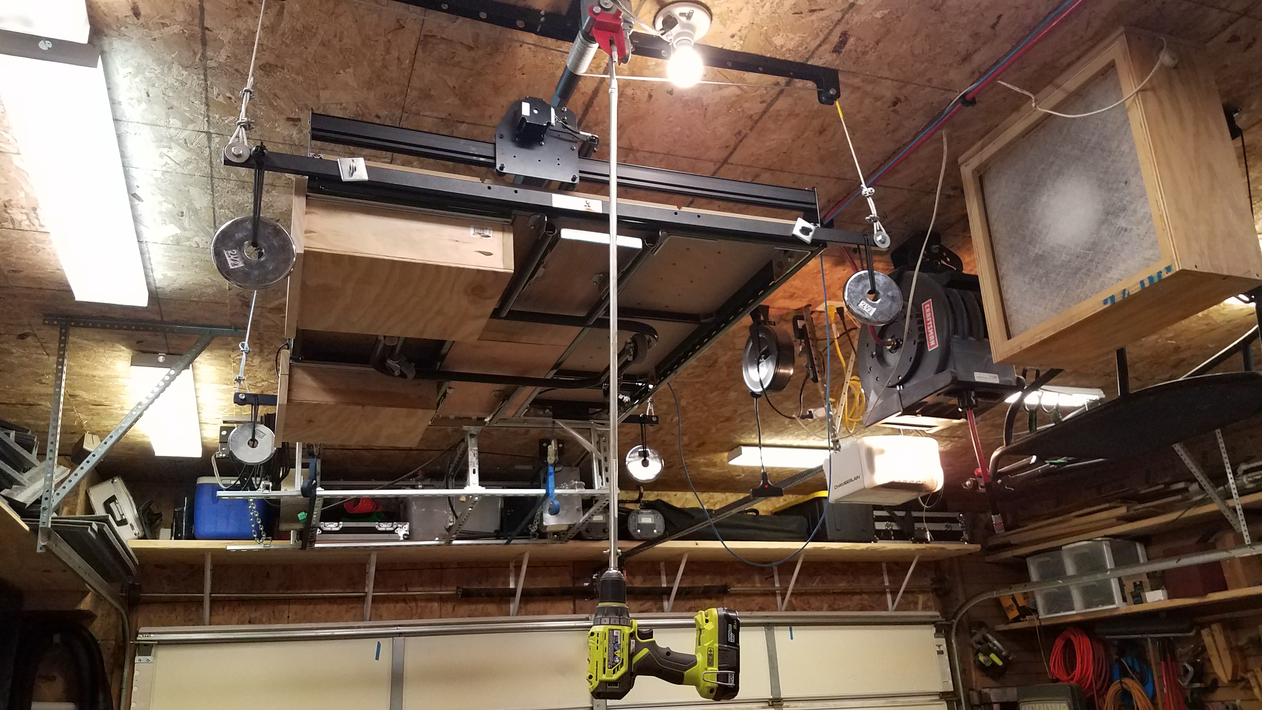

After commenting on another thread about airflow when carving materials that melt, I decided to snap some photos of my setup. Perhaps someone might pick up on something that could help them. First things first, my shop is your standard 2 car garage. We do park 2 vehicles in the garage at night so all my horizontal work surfaces and tools are on wheels. I don’t have the wall space to give to having the xcarve flip up against a wall, and I wasn’t to keen on taking the time to set up the machine just to tilt the thing on edge and have it possibly get out of whack.
So I got a drill powered ceiling storage lift. Capacity is 250 pounds.
It has a locking mechanism and it came with an adapter to chuck it into a cordless drill to wind it up and down.
The black bars that came with the lift are meant to have this wire shelving stuff spanning in between to hold stuff. I discarded the wire shelving and drilled a couple holes in the black bars so they could be bolted right to the table itself.
The table itself is made from Unistrut. this stuff is meant to be used to hang conduit and pipes from overhead. Pretty common stuff. It uses these special nuts that grab on to a lip on the inside of the unistrut. It is a pretty slick system. The square washers and the L brackets are part of the same system. Everything is put together with 3/8-16 bolts, washers and nuts. I added some 2x12 wood in the middle so I had a place to mount the legs. These are your standard, locking banquet table legs. the ones I got lock in both the up and down positions. I welded t-nuts to the bottom of the legs, then cut a hole in the center of the plastic foot that came with the legs so I could screw in the casters. Also, the legs are installed just slightly offset so they will fold up.
I have a 2 1/2 pound weight hanging on each end of the black bars. I found that in order to wind the mounting bars up out of the way, you need a little weight or the steel cable gets snarled up. One of the bars has a network cable attached to it. The cable goes up to the ceiling, over to the common house wall, then into the house and connects directly to the router. I have another cat5 cable attached to the xcarve table that gives me enough slack to move the xcarve pretty much anywhere around the shop.

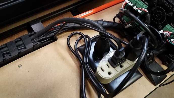

I got the inventables extension wing and just behind where the xcontroller mounts is a space just big enough for an outlet. I wired up and extension cord and voila!

So basically, I can drop this thing down, use it, then when I am done, the whole thing packs up, and goes back up to the ceiling out of the way. I have a job booked in about a month that is going to require taking the xcarve on the road. I have a set of short legs with wheels that will let me roll the entire table into the back of my SUV and still have room for the other tools I will ned underneath.
