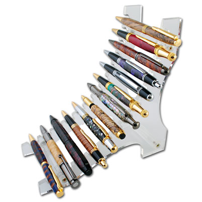

Yes tons of awesome designs out there…the problem I have is im not good at transferring my ideas onto v carve or easel…my design skills are lacking …so im hoping to get help for a starting point that I can modify myself maybe?
Here is a fast knock up I did making a nice angled unit The idea is the tip is just a dimple for the pen to rest in the back is offset to allow a pen to sit in a half circle. the project shows the parts sitting on top of each other so you would cut both top and bottom at .75 depth but the upper thru holes on the top would be drilled in then cut to the matching triangle with cut outs on the profile. I don’t use Easle anymore graduated into vcarve but it is a very good tool to get on the path. A Pen stand in general is a good started to cruise the web for ideas then see how you would be able to make it.
