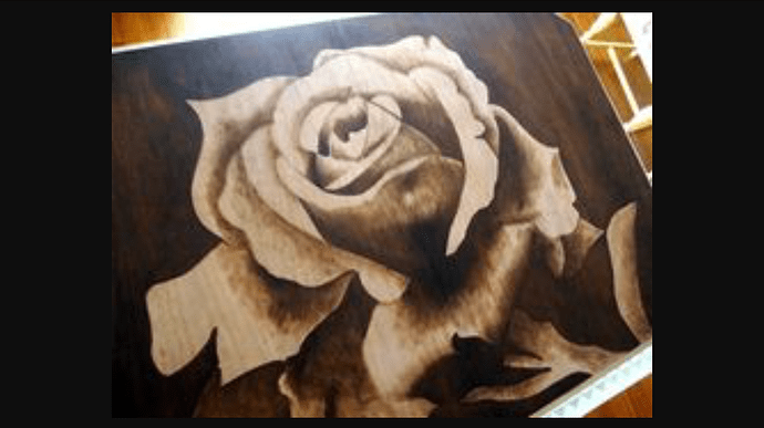

I think it would be really interesting to glue up a one inch thick board from 4 different 1/4 inch boards, Using a very dark wood like Wenge contrasted with a light wood like the cherry would make for a relief that had the color built right into the wood.
I like your idea, using different colored woods would allow you to make a “cameo” kind of thing. Your original post talked about finishes. I have had some success using a buffer with white diamond compound and then some hard carnauba wax. This has given poplar an almost stone like sheen.
