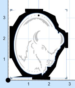

Was running a simple project today but found what the preview was showing did not accurately show the result. I was trying to totally cut out the shape and the preview showed it should be OK.
Preview1
But when finished it was still attached in three places. Any thoughts. (Yea, the cut out is a mess but still think it should have rendered correctly.)
Those are tabs. If you select your outline in the CAD view, you’ll see yellow spots that match where you see those on the cut.
Looks like detailed preview doesn’t render tabs.

In the interim you can see where the tabs are on the left side with the yellow marks. You can adjust their length, height, and the number of them. (screen shot below)
No, I don’t think these were tabs. It appears to me when carving Easel saw these areas as too narrow to cut with the 1/16" bit. When I added some “extra” cut through area using rectangular blocks it then cut correctly all the way around. It is just that the preview said it was good to go the first time but it didn’t work out that way.

Did you cut it with a 30 degree V bit like you have in the file?
If so one possible explanation is the thickness of the material is actually less than 0.125 in. That would cause the behavior in your first photo.

BUT, looking at it again I think you are right about it V carving at least part of the exterior. I decided to remove the V bit from the project and see what the cut looked like. The result is below and it is exactly what resulted. Apparently the clearance was too tight for the straight bit in those three areas and it was using the V bit to complete it. Makes total sense. (That’s the whole purpose of the Roughing/Detail pass thing isn’t it!)
