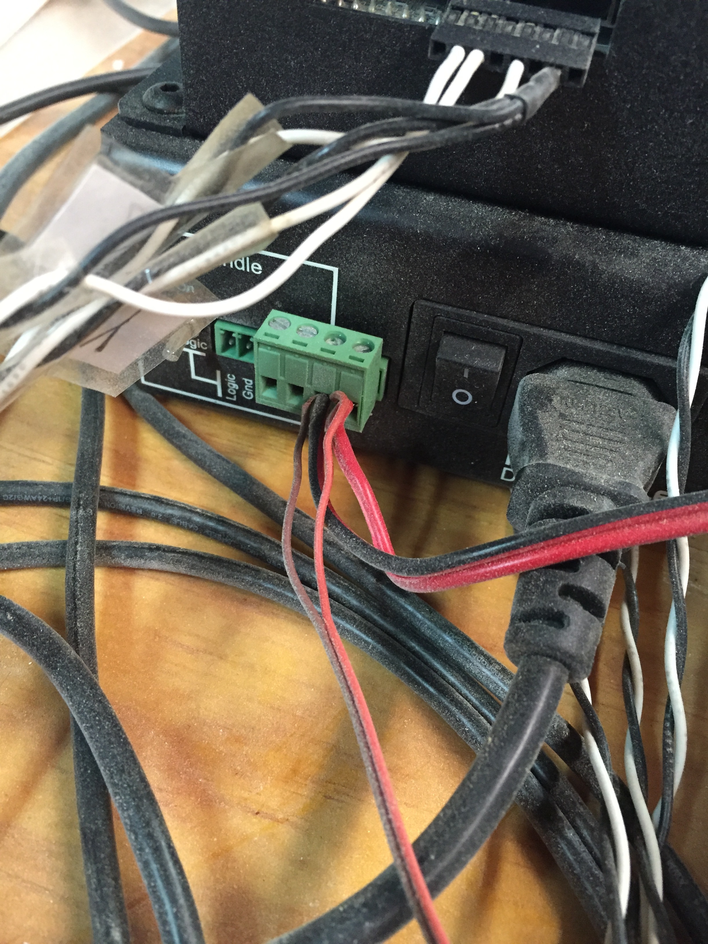

I ordered the brush from mcmaster carr that others have recommended and installed it in a groove cut in the 1/2" plexi. A small set screw on the side secures the shoe in place. I threw a ring light from super bright leds. Works like a champ and looks good. I just need to buff out the plexi to make it clear again as i cut it out of a nasty scrap.
I wired the led to the controller power supply so when the xcarve is on i have light.

Where did you purchased the led ?
Kristian
I think @JosephMcdaniels meant from the supplier SuperBrightLeds
where did you connect the lamp
And is it 12 volt dc
@JosephMcdaniels
is this design on easel?
Thanks
You can pull the 12 v of the x carve power supply. That way when you turn on the x carve you have light.
Sorry I did it in fusion 360. Be happy to share the model or the Gcode let me know.
Joseph
Please tell me where the 12 volt is on my x-carve (if you know)
Or some one else that maby knows
Look on your power supply. On the green terminal block there is v+ and v- that’s where you connect it in parrellel with the wires going to the arduino.
Joseph
I have checked there, with my instrument
but I had no power there
strange…
