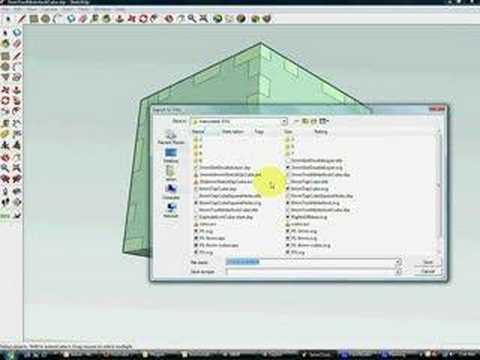

Ok, here goes:
First, you could export your vectors from SketchUp as seen here:
You could also use these dimensions to create the vectors in Inkscape or Illustrator and for the purposes of this tutorial, I’ll be doing this with Illustrator. I’ll also try and keep this post as short and simple as I can, so if you find you need more information on a specific step, then feel free to ask.

Import and set depth in Easel
Ok so here I am pretending that I am going to be carving these parts out of a single block of wood that is already the height of our tallest part… so 1.5 inches. as a side note, I would probably go about milling these from separate pieces of wood, but there could be good reasons for doing it this way
Again, it is probably easer to see it in the video, so here you go:
