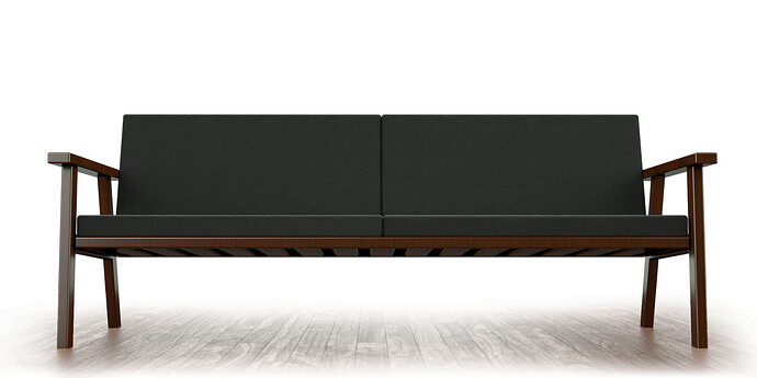

I’m about to build a couch for our living room and think I will be going with a can of the walnut stain.

here’s a render of an iteration of it.
That might not be Chris Christie compatible… but I like the design.
Thanks! good thing it’s not for Chris Christie
