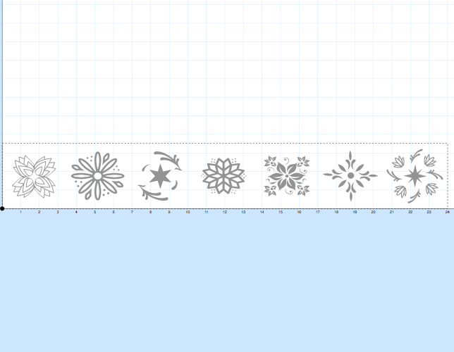

My daughter designed all of these ornaments in Easel. She used elements of the existing ‘icons’ available within Easel and cut/pasted/edited points of the various pieces. There are two workpieces, the first is used with a 60d vBit, the second workpiece is for a straight bit to cut them out. Carve, flip them over, carve the other side. Hang on your tree and enjoy!

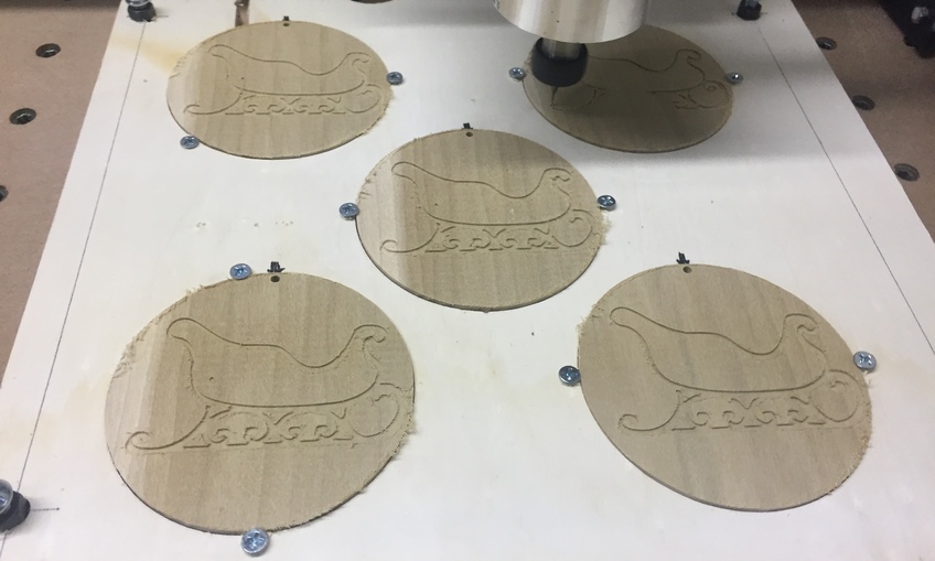

I created a jig for batching out these sorts of ornaments and locating the blanks for engravings on both sides. The gcode can be generated with easel but I used UGS to manage work coordinates and tool probing between operations.
Very nice. When I flipped my board over, it messed up the alignment. Perhaps this jig will work better. :wink:
Wait…you used UGS?!? Really? :smile:
Nice looking jig. I like the screws as hold downs.
