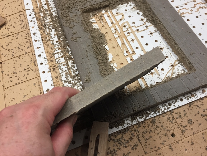

It carved just fine with my 1/4 downcut bit and plywood settings. Good chips and a smooth cut. It did get a bit warm to the touch but not hot enough to cause any issues. I think I can cut much more aggressively. I will have to experiment and see if I can up the settings

I did a 3D carve with the composite decking this weekend.
I used my fast “pine” settings. It carved easily, with nice chips no dust. It reminds me of milling wax.
This stuff carves really well. I wish it came in wider sheets, I could use it for more outdoor projects.

I used Trex Fascia board as that is what my local store had in stock.
I used my normal wood settings and bits.
It carved beautifully. More like wax than wood or plastic. (with plastic you have to worry about the chips melting and clogging things up)
Here it is after sitting in the yard for years. It has held up to weather and sun much better than pressure treat or acrylic would have.
