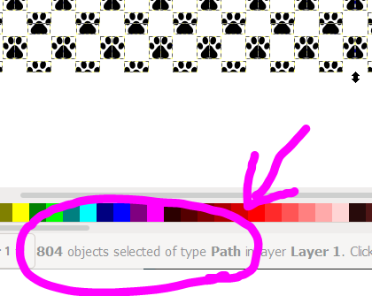

Start with your two svg files.
Ungroup the pattern until you have individual paths.
Combine the paths (CTRL + K).
Scale and place the pattern path. I reduced opacity.
Also, send it to the bottom (END).
Select your group of text paths, ungroup (CTRL+Shift+G) , combine (CTRL+K), and duplicate (CTRL+D).
Shift select your pattern (the duplicate text and the pattern should be selected).
Path --> Intersection (or CTRL+*).
Save, and import into Easel.
Amazing!! Thank you both for your help. I was missing the ctrl+k step. I really appreciate it
