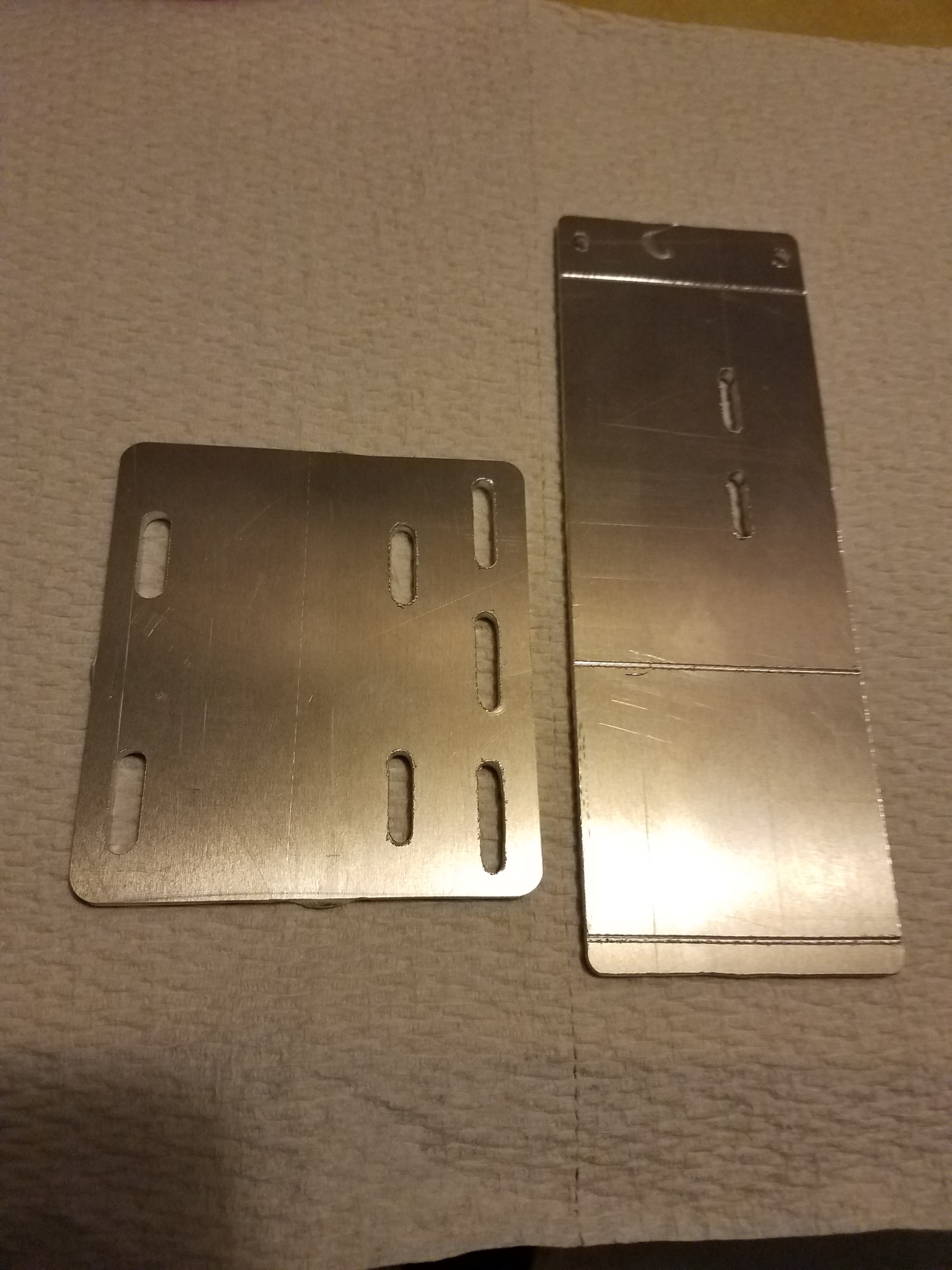

Phil, Thanks for the file and your input on the setting. Only broke one bit and that was because I didn’t change a setting for the feed for the slots. Just need to sand the edges to take off whats left of the tabs and burrs.
