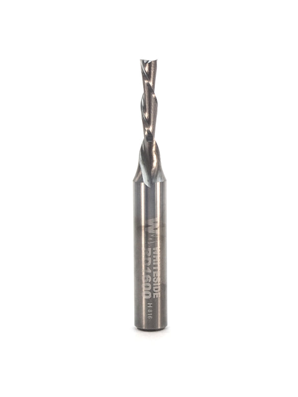

I use this 1/8” downcut:
It’s sold on Amazon but only a 0.5” cutting length.
You might be hard pressed to find a longer cutting length in downcut. But if you do half using a downcut, then you can switch to an upcut for the last half.
Compression bits, as previously mentioned, are only good if you can go full depth of cut where both the up and down are engaged at the same time. Most likely not possible with an Xcarve but other more industrial CNCs could do it.

I buy my 1/16" and 1/8" downcut from drillman1 on eBay. Just bought a 1/4" downcut whiteside off amazon. For cutting through 3/4" material, including plywood I use a 1/8" straight cut bit. It requires a quick couple passes with a 220 grit sanding sponge for some fuzzies as the bit gets dull, but there has never been any tear out or problems on plywood.
The one carbide down cut bit I bought on Amazon arrived yesterday afternoon. I did a few profile and pocket carves last night to test it out. Holy Crap that’s so awesome. Thank you everyone for leading me in the right direction with cutting wood!
