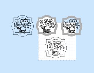

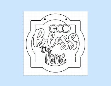

Fairly new to the world of Easel but still having a few problems. On my piece below, I created and combined God Bless this Home but now I’m having a problem combining it with my frame. Any suggestion or help. See link below. Thanks, Mickey

Set the inside of the frame to pocket cut at a depth of zero
Set the outside frame to pocket cut at a depth greater than zero, say one
Then select the inside frame and outside frame and combine
Then select everything and combine
Good Luck
Russell
Thank you so much RussellCrawford
