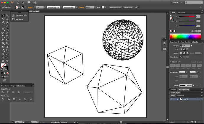

After a bit of poking around in a few of the 3D packages I typical use I found a way to get a really nice vector wireframe quickly from a 3D model out of Maya. A small bit of Maya knowledge required.
Maya has a vector renderer that I have never really had a use for. After reading your post I took a second look and found it is actually quite useful for something like this.
Frame the shot and render using the Vector Renderer with “Adobe Illustrator” as the file type
Maya renders the current frame to an .ai file with really nice clean vector lines. No tracing needed.
Aside from wireframe renders you can get some nice vector paths with color and shading data as well.
I have access to a full version of Maya. But it looks like you have access to the vector renderer in the free educational version too as long as you use the version for “students of the faculty of Architecture” according to a web search.
