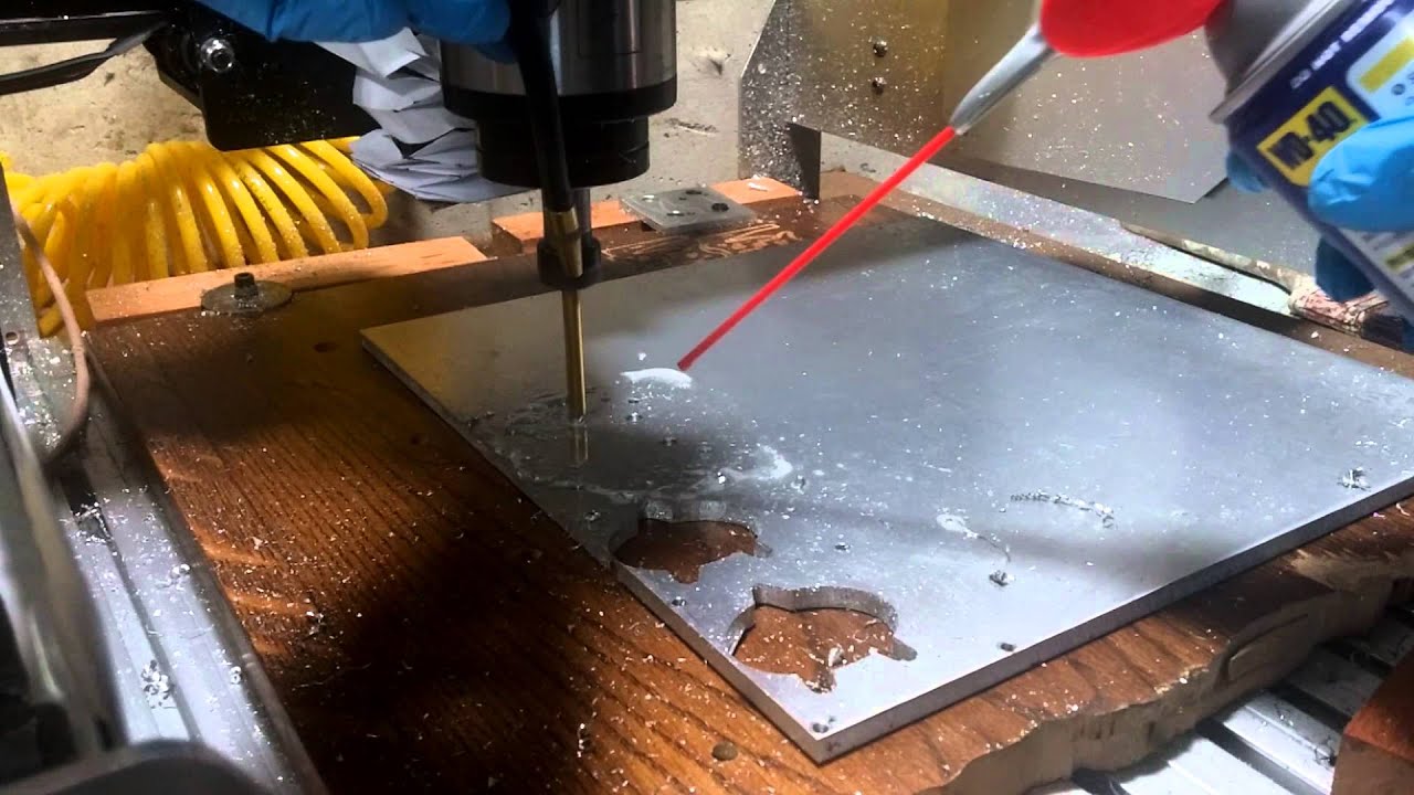

And the first video in the series, cutting the stepper mount for the Z:
Do you have objectives for the build? Is there a certain amount of work you’ll have the machine doing or certain levels of rigidity that you are looking to achieve?
Is there a specific reason you went with a full depth pocket for the circle cutout? My guess is for the finish, but maybe not…
The objective is to be able to push a 1/8" end mill to it’s limits in aluminum. Basically, using GWizard you get feeds and speeds but generally speaking I have to dial them back quite a bit so the frame can take it and not chatter. Currently Im doing a .01" depth of cut when profiling, I’m hoping to be able to hit .04" at the same feed rate/RPM.
I did a full pocket because of the thick material. Chip evacuation in aluminum is critical espeically in materials atleast .25" thick. Recutting chips can cause chatter/vibration which will cause your endmill to chip and soon snap in half. Im playing it safe by doing a pocket instead of a outline with tabs (at the cost of tool life).

I need that EXACT stepper mount for the EXACT same purpose! My Z was set for a NEMA 17. It looks like you are ramping the plunge on your profile cut, because I see your feedrate slow down periodically. It looks like the ramp is .01" over a .5" run. I had my last experiment set to “ramp” but it continually ramped down throughout the cut. So every inch or so it went down about .001" Do you think that would be a problem?
Also, would it be better for my less powerful 600 watt spindle and manual chip evacuation to “Pocket” the profile cut? Like a .2" pocket profile using the .125" bit?
Hey, I welcome the questions, I get to flex a little bit
Continuous ramp is essentially a boring operation, and so long as you aren’t cutting more than the maximum step down you set (in my case .01") you should be okay. There might be some strain on the z-stepper, I’m not familiar with NEMA17s or their power, but I don’t think it will be too big of a problem. I have mine set to a 6 degree ramp that slows down to 15"/min or so. The CAM operation can take distance, but I find manufacturers list their ramp in degrees so I always use that.
I think pocketing is a really safe operation in terms of chip evacuation. Granted if the pocket is way too small you can still have problems. The good news is that a .2" pocket is small enough to bore out. I usually do this for holes that are less than 2x the cutting diameter (.25" wide for 1/8" endmill). It’ll go a lot faster and you shouldn’t have too big of an issue with chips.

Tried to cut setting 600watt spindle to 20,000 rpms, .05 DOC, 30 ipm, 6 degree ramp, destiny viper. It was better but still awful, the cheap spindle dogs when cutting significantly reducing the rpms. I will try again with the Makita installed in place of the spindle, as soon as the Elaire collet arrives (all my aluminum bits are 1/8th ").

Also - your settings worked PERFECTLY on my original x-carve. I cut Christmas trees out of 1/8" aluminum and the sides were very, very smooth! So excited to try it on my dedicated aluminum machine when my collete comes in. Thanks again. I cut a pocket into my wasteboard exactlyl the size of the stock so it “Snaps in”. Then I screw it down.

– 1/8" 2 Flute uncoated – (2) boring operations and the “engrave”
.03" DOC (I’ve hit .05" DOC, but I wanted a cleaner edge for the engrave)
Slotting
60IPM
20K RPM
