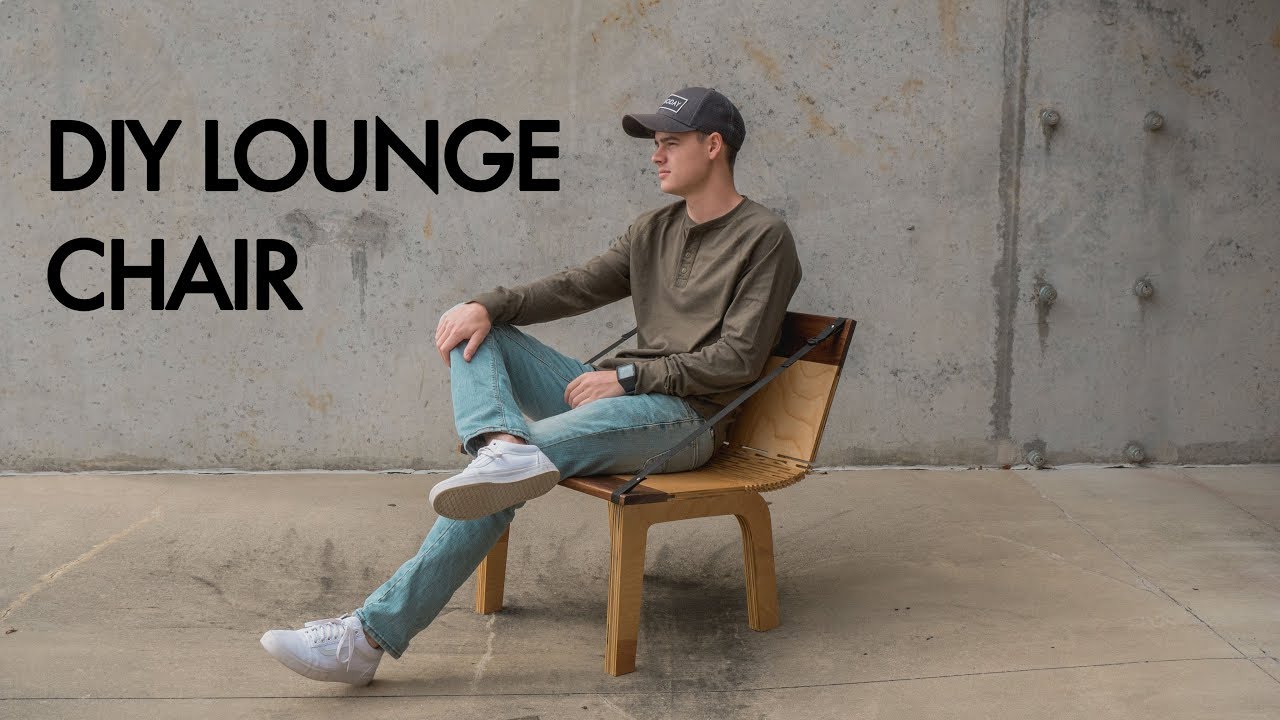

Dylan and Molly at Woodbrew made a living hinge lounge chair with their X-Carve:
At the end of the video, they’re asking for recommendations for how they could improve the design. Has anyone else made large-scale living hinge pieces like this? I’m sure they’d love some insights if you wanted to share in the comments of their video!
…But also, I just really want to know because I want to make one of these chairs :tipping_hand_woman: :stuck_out_tongue_winking_eye:
