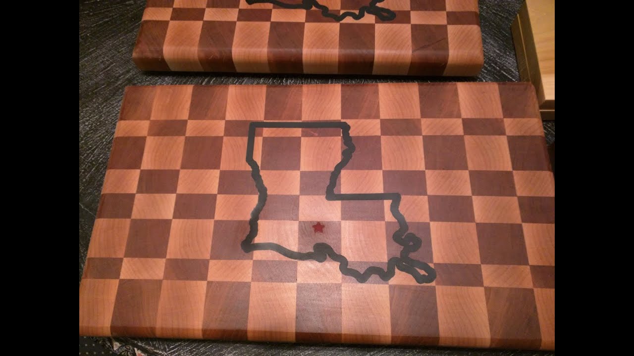

I like Art Resin- found it online and use Jacquard’s Pearl Ex pigment. I haven’t experimented with mixing pigments, they’re expensive so I stick to a single color mixed into the epoxy. I found the Art Resin repeatedly referred to as ‘food safe.’
Attached are images of a customized clip board (no coats of polyurethane added yet in this photo) I’m working on tonight, as well as a cutting board (finished with mineral oil and beeswax mixture). I haven’t gotten brave enough to try using a contrasting wood for an inlay- that’s next!

I’ve used ArtResin in my projects. I did an epoxy inlay on a cutting board here and also discussed some lessons learned I had when mixing and pouring. I just used some acrylic paint as a colorant:
