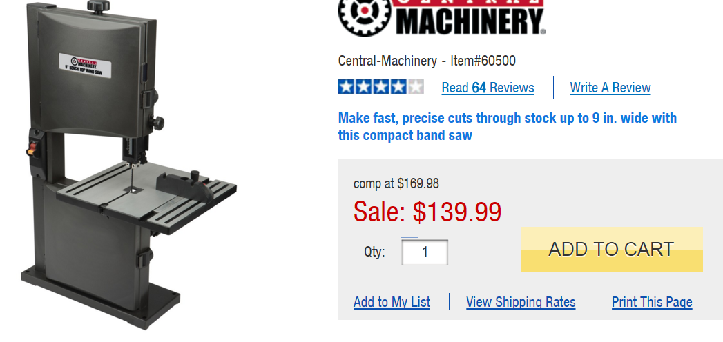

I have found that a band saw really helps me dimension the wood to approximate thickness. I can buy 5/4 lumber at much lower prices in my local lumber yard and then use the band saw to slice it into 4 approximately quarter inch pieces. Much better use of the wood than just turning it into sawdust.
I was thinking the same thing in a smaller scale, until I can afford a nice bandsaw
http://www.amazon.com/Gyokucho-Double-Ryoba-RazorSaw-Woodworker/dp/B00BSQU9UQ?ie=UTF8&psc=1&redirect=true&ref_=ox_sc_sfl_title_4&smid=A2YR3NFJ41VU11
You can pickup a 9 inch band saw for only $100 more
http://www.harborfreight.com/13-hp-9-in-benchtop-band-saw-60500.html
3-5/8 in thick material is very limited. Aiming for a 13" resaw, same as my planer
Saving for something like this.
