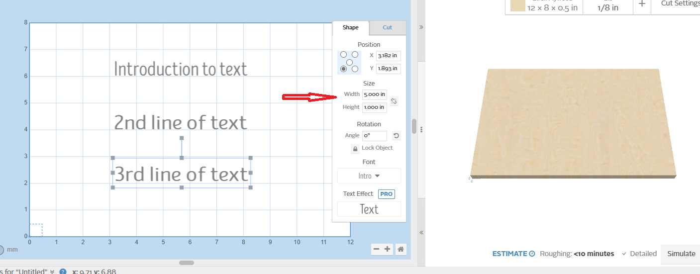

I write a sentence and enter the specific measurements (W-H) and click lock. Up to this point every thing is great. When I enter the next sentence and state same measurements, the sentence is slightly different in height. Any suggestions?
Here are 3 sentences that are 1" high and 5 inches long. It appears that the more letters you have in a line, the thinner they become to stay within those confines.
Thanks Martin that makes a lot of sense.Happy to say you made my day.
