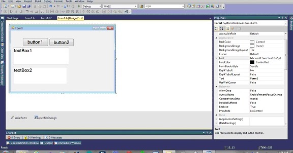

It is actually a lot easier than that. Just drag this guy onto the form.
You will need to deal with threading issues, but a simple google search will show you how to deal with that. The serial data will come from a separate thread than the form controls.

Awesome, It’s been a little while since I’ve used Studio, looks like it might not be too bad.
When you are loading gcode in, are you sending your program an NC file? If so how do you allow your code to read it?
Yes I understand that. I’m curious if it just the same as sending a text file.
