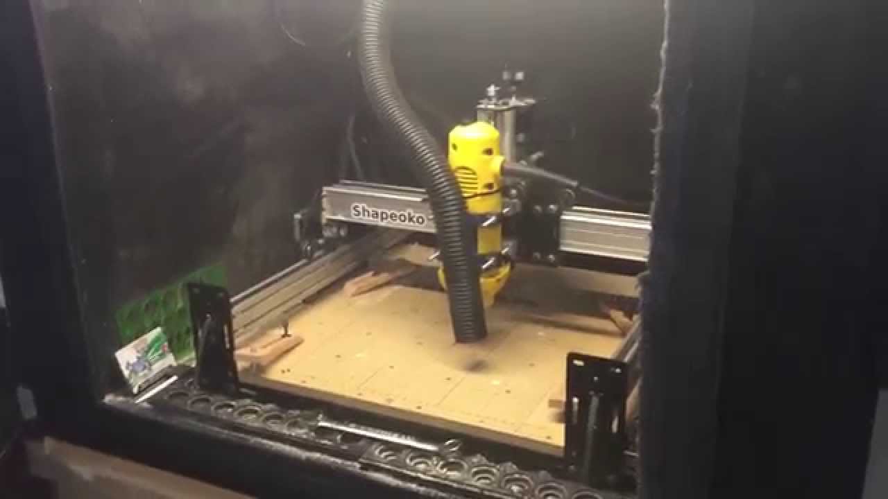

My initial idea was based around @tjshape’s build on the Shapeoko forum.
It’s essentially a massive 2x4 frame skinned internally/externally with 1/2" soundboard and 1/4" drywall. It uses Denim R13 insulation for a dead space filler and green glue sealant/compound to stifle any leaks. I’m sure a lot of people have already seen @tjshape’s proof of concept video, but I’m going to share it again because I am truly astonished by how well it works.
The obvious downside to this, especially for a 1000mm machine is that the damn thing ends up being the size of a dumpster. I’m scared to even guesstimate how much it’s going to weigh. Unfortunately, due to space restraints, I would have to mount the door hinges on the X-axis instead of the Z-axis. So I’m not 100% certain that I’ll even be able to lift it. Lastly, due to all of the sealant/compound, I’m not sure that it could be disassembled and relocated without destroying its structural integrity. But this could certainly be due to design flaws on my part.
I also came across a different enclosure by Protocorner on Youtube that operates using the same principle but at a fraction of the price/weight.
His design is basically just a 1/2" plywood outer shell, “Mineral Wull insulation” (not sure what that is), and a 1/2" drywall inner shell covered in carpet with a baffle box over the intake. I doubt it’s anywhere near as efficient as @tjshape’s design but it nonetheless cut down the noise significantly on his video. And best of all… it’s modular.
Does anyone here have experience with an enclosure utilizing this type of construction? It would be so much easier to build and transport, which makes me question whether or not it is too good to be true.

I needed to build a soundproof enclosure for my modified X-Carve as I run it inside the house in the unfinished basement. I use a small shop vac for dust collection and that coupled with the router while it’s cutting could hit around 98dB from about 8’ away, which was much too loud for inside the house. With the enclosure closed, cutting MDF and vacuum off, it hovers around 58dB. With the vacuum on while cutting MDF, it hovers around 63dB. So it was totally worth it for me since I run it inside (although quite expensive). I did buy a lot of acoustic foam to line the inside of the enclosure too but I never ended up installing it.
Although my design probably won’t work for you since the completed enclosure is a tank (the doors on each side weigh 97lbs each) and quite large, you may be able to take something from it/strip it down and find something that works for you. Here are a few images of the enclosure and I can send you more photos (or the Sketchup file) if you could benefit from it.

I’ve just finished building my enclosure. I’m planning to move house in a few months so it had to come apart. I made a torsion box base from 2x4" and 18mm plywood. I then made a back and two sides which are a basic frame filled with sheep wool ( i get these home delivery food boxes and the cold stuff comes wrapped in sheep wool bags so I’ve got tons of the stuff at 0 cost) these were then skinned with 6mm MDF inside and out.
The doors are just 18mm MDF with double glazed acrilyic windows.
I was going to do a lift up front but i don’t have the head room in my current workshop.
My box is 700mm tall to give clearance for the machine with the Z axis at its highest and room for the dust collection. I did some testing, back ground noise with everything off is 48dB in my shop, with the doors open and the machine cutting it jumps to around 90db+ with the doors shut its down to 67/69dB so its a big improvement. Its by no means silent but its workable and with the shop doors closed it a background noise.
