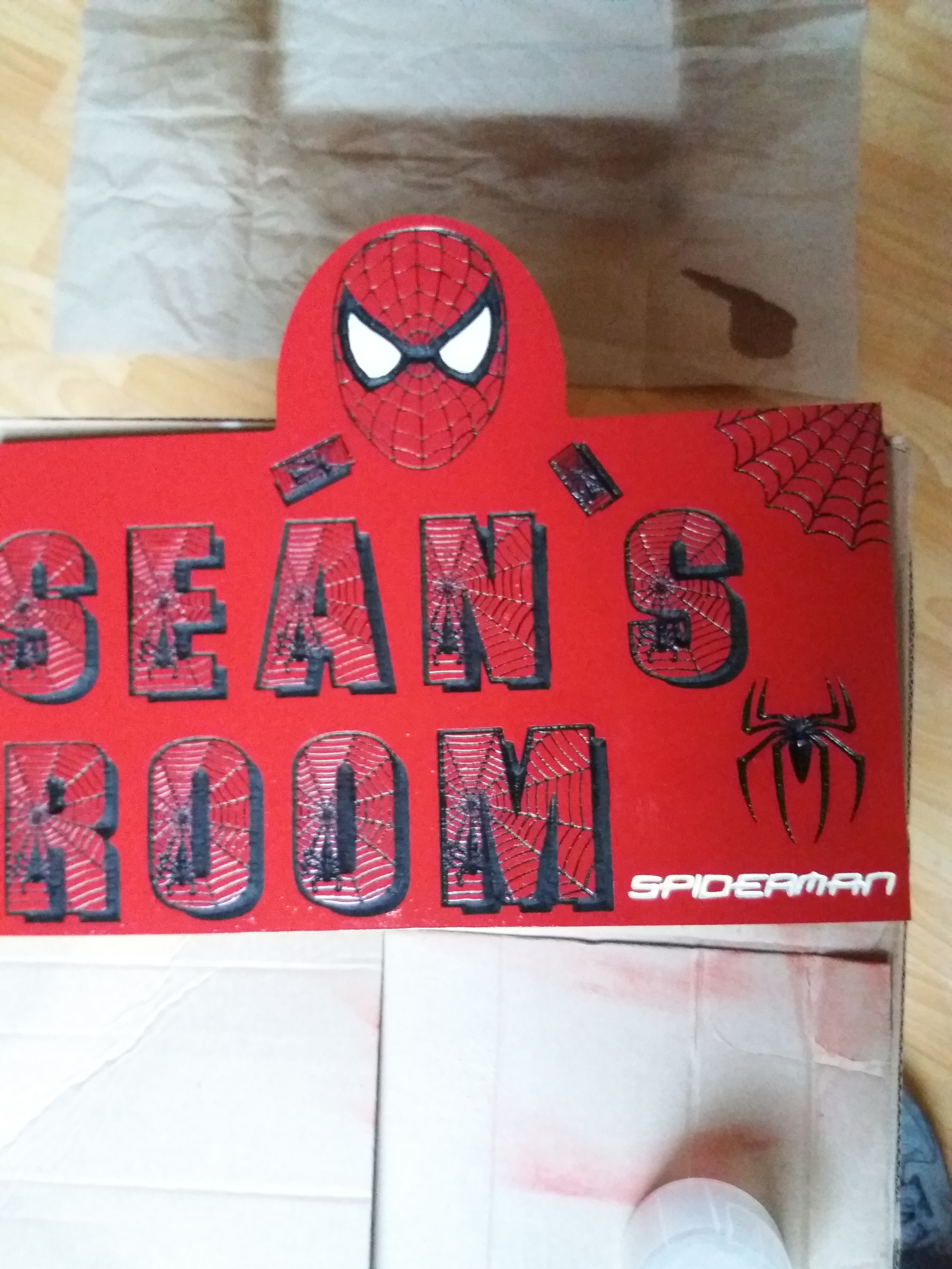

A lady in work was telling me her daughter was finding it hard to get a room sign for her son whos name is seán. All the signs she seen didn’t have the fada over the “a”. She was saying he is mad about Spiderman so I thought I’d have a mess around on easel pro seen as I had one free carve day left and wanted to try out a spiderman font I found.
I gave a 290mm x 230mm bit of mdf a couple of coats of red that I had lying around and when it dried stuck a sheet of vinyl over it to make a paint mask.
I only had a 20° & 90° v bit to hand and the 20° looked way to long to carve for a practice so I used the 90°.
The webbing on the txt was tiny so it didn’t turn out the best
I gave it a it few coats of black spay paint earlier so I’'ll pull the vinyl off in a bit and see how it turns out

Thanks. Picking off the vinyl is a pain in the backside lol
Cool font. Would you mind sharing where you got it?

Just a quick update . Just redone this sign

Super easy to do. If you have VCarve. Or any program to trace a bitmap.

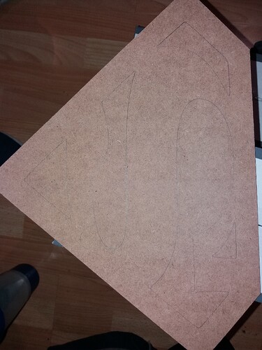

@CurtisCummings how Superman?
They need another coat of paint then some poly.
I want V carve badly. All I have is easel and
Adobe illustrator for now:frowning:
You can never go wrong with Superman.
I loved the movies myself when I was younger
Hey curtis, can I ask where you got the vector for this. I have the lady othe spiderman sign and the haughter wants a hulk one for her son now. Did you use a v bit for that?
@CurtisCummings
