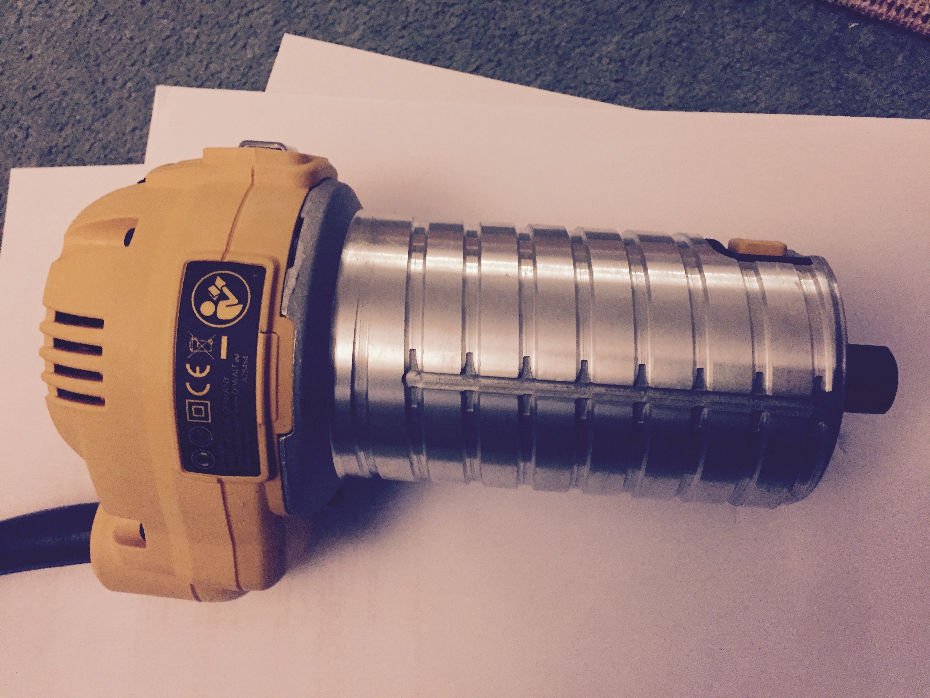

FACT: the 300W 24VDC SPINDLE of my x-carve 50x50 DIED.
The options are:
  • Inventables sents me a new spindle.
  • Inventables sents me a mount for a different router
I am in a 220V-country, so DeWalt 611 is out.
  • DeWalt D26200 seems to be the European alternative, looks a lot bigger and I have seen some discussion that it woudn’t fit the 611-mount and would be too heavy.
    Will DeWalt D26200 fit the mount? Won’t it be too heavy?
  • It is quite expensive too. Are there cheaper 220V alternatives?
  • I work very small. Will small bits fit?
  • I have neighbours. How loud will it be?
  • Since it has more power, will it cut through hard wood faster than the custom spindle? Can I give it more depth per pass? (that would be an advantage for me)
I should be able to answer most of these questions tomorrow when I expect to receive a DeWalt mount (My standard spindle died also) . My DW26200 arrived this morning. I had understood that that the DW26200 was identical to the DW611.

I have just put a caliper across my DW26200 and I reckon it is between 68.8mm to 69.1 (the variance could have been down to my hand shaking with the prospect that I had bought the wrong unit lol).
It seems quite a bit heavier than the standard spindle.

If you want cheaper way to do this, you better stick with 661 mount, if it’s a little bigger on outside diameter, you can pray open the 661 mount it fits. But when you’re saying you’re in 220 world, you have lot better altenatives then we have in 120 world. Just go either Amazon.com or Ebay.com, and say 220 CNC spindle. Your head will spin.
I am using a Makita 220V router with a 3D printed dust shoe… Works great!
For the additional weight, If you have NEMA 23’s and not 17’s you should be okay…
As for the bits/endmills, if you using anything in the 1/8" and smaller range (shank diameter) then you need to get a collet kit. For example the 611 has a collet for 1/4" I’d advise not getting a collet reducer and get a proper kit that uses ER11 or ER16 collets.
As for loudness of the 611. At full power It’s pretty damn loud.
Increased cutting speeds is a fine balancing act of spindle speeds and feed rates. As in are you steppers able to reliably able to provide the feedrate for higher spindle spindle. ii.e. I have NEMA 23 (425oz-in) and matching external drivers. I am able to blow thru hardwood at around 2575mm/min. And with the additional ‘oomph’ on the Z access, I can plunge faster.

I have finally managed to get hold of the DeWalt mount and installation was remarkably simple.
The DeWalt DW26200 slipped into the mount very easily. It is not as noisy as I was expecting and as others have said the blower on the router does spray the dust around.

Customer Service sent me a new spindle and a mount for the Dewalt 611. Today I have installed the new spindle, but it the first two carvings I did were just as offset… Really frustrating.
So now the nost important question is: Does the DeWalt stay on track?
Mine does. I do not have an signal noise causing the stepper to move when the spindle is on.
However, it is a lot heavier so you need to readjust and tune everything. Check your v-wheels, especially on the X axis. They may be too tight with the new load.
Also some kind of stiffening mod is needed. The gantry will twist noticeably with the extra weight. After I did my stiffing mod I saw a huge increase in quality.
