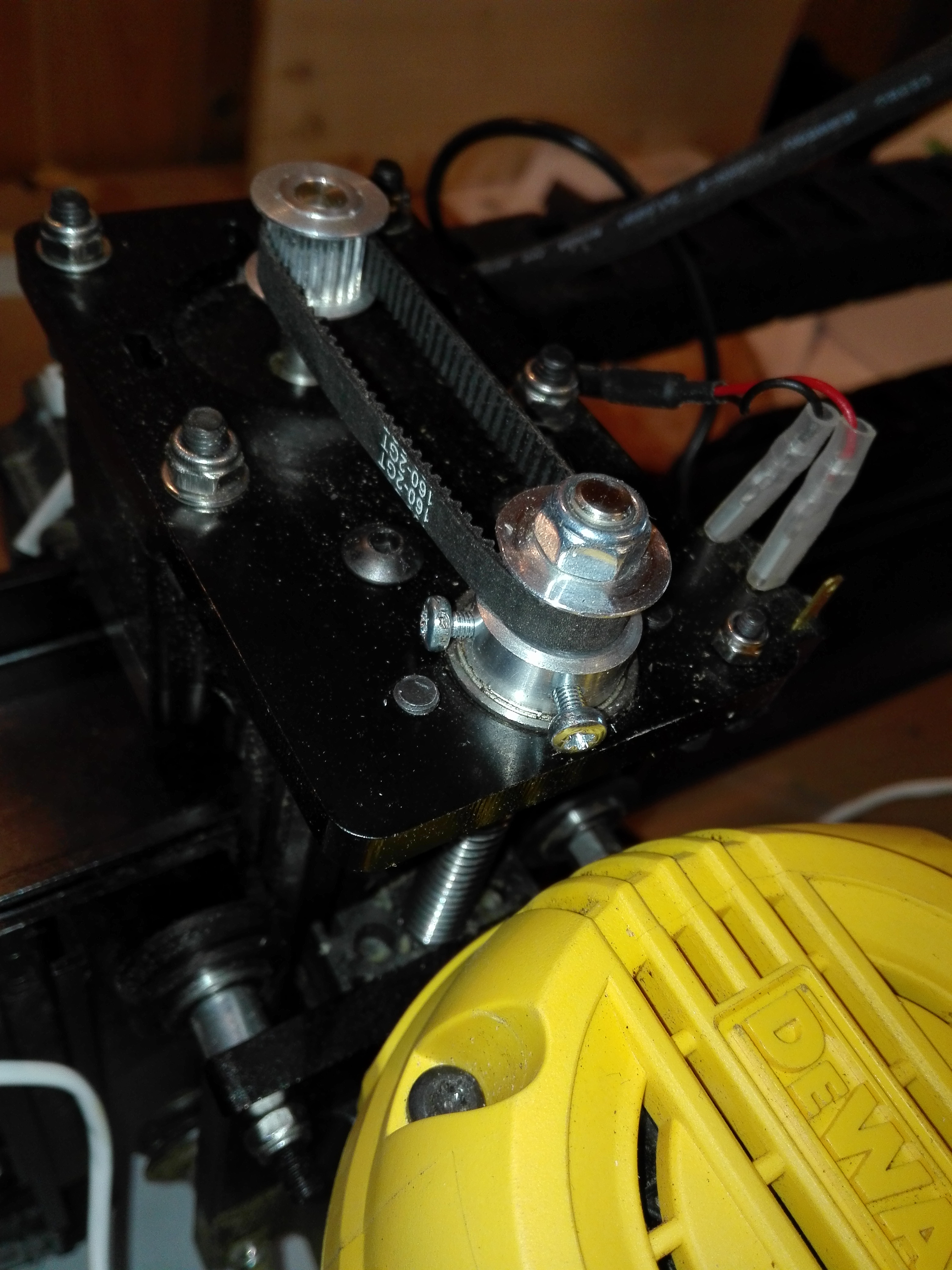

Collet and what remains of the pin are still screwed on the router. So blackened that I fear I’ll never be able to detach them. Sorry for the bad picture quality
The nut, pulley and screw near the z belt are still attached, but now when give a Z+ or - jog, the pulles turns without making the screw turn. Acme is still attached to screw.
The z mount bottom wheels went down too much.
I have found that one of the small set screws that hold the pulley to the head of the leadscrew is now lost
(this picture is from the instructions, X-Carve Instructions: Lead Screw)
Replace with M3 socket heads. I think 6 or 8mm length. You can get more torque and see them better.

It worked
I can now use the Z axis again.
Plus, since now it is cold here, I managed to remove the bit and collet, so I’m back in action.
