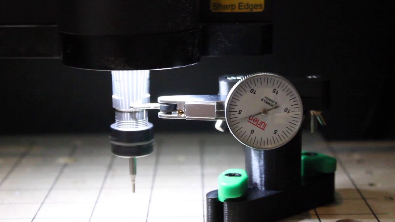

Here’s a little clip of me checking the runout on the spindle and the tool, I think that I could adjust the tool’s runout a little to get it better, but with this much runout on the spindle alone, I doubt I would get it centered enough.
I made this little rig to hold the dial indicator:
@WorkinWoods
You are absolutely right, my biggest worry is the shaft’s runout, I might be able to tap the tool straight and tighten in the collet, but if the whole thing wobbles, it won’t be possible to get the tool straight (I guess).

Here is another clip of what this spindle looks like taken apart, I am not sure if this is exact one they equip Carvey’s with, but if it is, then I found a bunch of these on internet and their specs say that the runout should be between 0.01mm - 0.03mm (note that these are in mm) 0.0004" - 0.001" , but I haven’t found out if this is exactly what they use.
They just look identical.

personally I think runout needs to be checked it quite a few places even on the shank and cutting edge of the tool not just on the shaft of the spindle as the collet will introduce runout if not correct
also how are your pre-loading the collet nut? are you torquing it down to a specified value? and are you seated correctly in the collet and or using a collet plug?
I think thats why when using small tools like that the run-out will have to be checked each time and the collet nut torque needs to be monitored
I guess its a little easier on atc machines as you do all your tool setting on the bench and have precision iso tapers in the spindle of course I image it might have to be checked on that each time as well
hah! well by far I was only inserting the tool and tightening using included wrenches to what “felt right”, not too tight to strip the thread nor too loose to let it unscrew, but I had it once let loose, so I go a little harder on it now.
I don’t even know of any tool that would be able to torque the collet. Maybe a torque wrench with a deep socket would work just fine, but torquing it never crossed my mind. I will take that into consideration.
I totally agree with @AngusMcleod , that is why I definitely want a “somewhat” straight spindle before I start messing with straightening out tool inside the collet. I need the good start before I mess around with other runout.

A world of difference with a new spindle!
