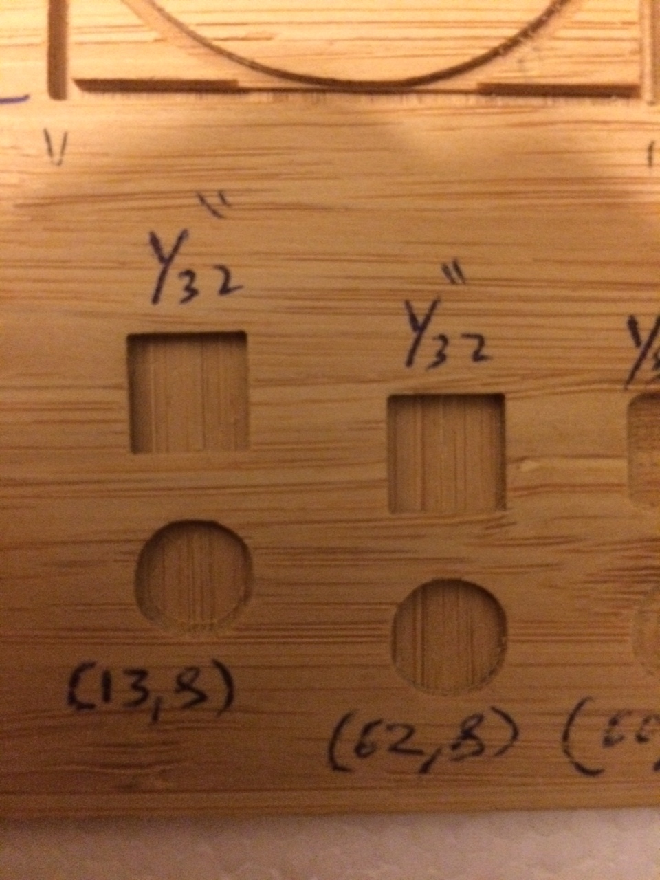

To me, this sounds like either the acceleration or max rate might be set to high, or voltage to low. With short movements, it does not get a chance to accelerate, however with long movements it tries to accelerate to its top speed.
Check your max speed and accel settings. ($120-$122 and $110-$112)
I believe I’m getting closer to a real circle now.
The second cut from the right is the result of last evenings work with re tensioning the X axis belt, eccentric nuts and ziptying all belts at the clip,
The first cut from the right is the result of modifying the steps per mm as measured over a 500mm distance. Both $100 & $101 were changed.
As you can see I’ve added a square (10mm X 10mm), and changed the depth of cut to 0.2mm from the default 0.7mm.
The square is cutting at a width of 9.40 to 9.45mm and a height of 9.87 to 9.90mm. It’s difficult to measure in hundredths of a millimeter with soft woods…
The circle still has an oblong/egg appearance, possibly it would be helpful to record a short video of the X-Carve cutting one of the circles. It’s visible when the bit is cutting from the center of the circle outward spiraling circles, especially at the bottom right quadrant that the bit is not traveling as far in the X direction as it is in the Y direction.
I am going to investigate microstepping / potentiometer adjustment as I’ve noticed a movement such as Y500, will result in a machine location of something like 500.015 instead of 500.000. The same happens when trying to bring it back to the home position. X/Y are within +/- .020 of 0.000.
Tomorrow I will have the 600mm ruler in 1/2mm increments that @RobertA_Rieke recommended earlier in this thread, which should further increase the steps per mm accuracy.
I tried increasing the X potentiometer in two increments of clockwise 1/8th turns. Didn’t seem to notice much of a change in roundness of the circle.
I did notice during the cutting of the circle that there is a hesitation when the bit is going to the bottom right quadrant, the bit travels downward more than it travels to the right. Possibly it’s a missed x axis step? I’ve included a short video of the circle being cut.
Currently the 10mm diameter circle is being cut oblong so that:
Try loosening up the X- and Y-axes belts a little bit. If the belt is too tight, it could be requiring the stepper motors to put more torque in to move and therefore losing the microsteps.
I had too much left over belt doubling back after the clip.
I was watching the X-Carve cut from the side and noticed the leading static wheel was rolling on and off of the excess belt. I really do feel a bit stupid for not catching this until now. In any event I pushed the excess belt down into the extruded aluminum and the 10mm circles & squares now look like this:
Both the squares & circles have almost no variation between cuts. The squares are 9.45mm wide (X), and 9.60mm tall (Y). The circles are still subtly oblong, ranging from 9.4mm to 9.7mm in diameter depending on the rotation of the caliper.
I am hopeful that upon re-calibrating the number of steps per mm in both directions that the squares will be closer to their prescribed 10mm size; and the circles will then lose that minor variation in their diameter.
