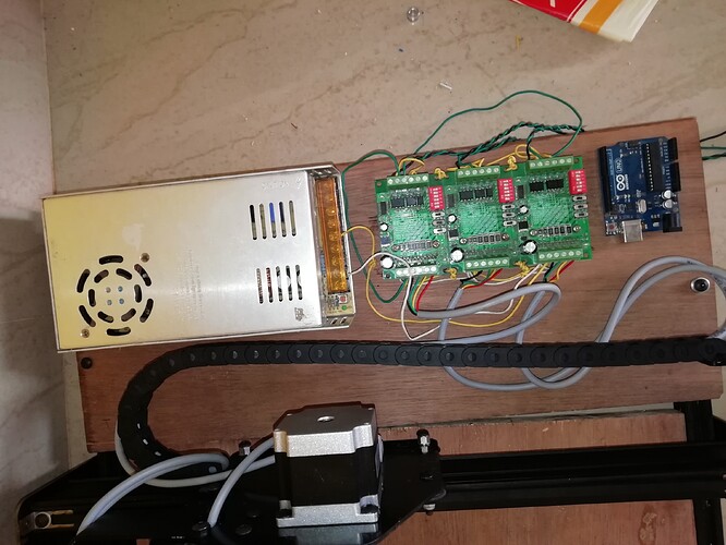

Look into Phil’s setup.
While it looks overbearing, it’s actually relatively simple to do and way cheaper. You’ve got a power supply and an Arduino, you really just need 4 $20 drivers and some hookup wire.
I might eventually upgrade to a similar setup (if I got a 2nd machine ever) just because I can go with a 48V power supply even though that’d be crazy overkill for an Xcarve.
I concur.
It seemed a bit daunting before I had everything on hand but the wiring it actually quite simple. Start with one driver to nail the “logic”, the other three just connect the same way.
I used TB6560´s on mine, there are better drivers available now (TB6600 and others)
Thank guys, I see what you mean. I read it over and look at the schematic and thought this might be over my head but now that I took some time to really understand what was needed, it really seems like the best route to go.
@HaldorLonningdal, did you not bother with the adafruit?
The Adafruit shield you mean?
If so, it is not required, you only need the Arduino + stepper drivers.
The screw shield just makes connections easier.
And there are other screw shields available that don’t require soldering. Check Amazon for some.
Oh the screw/terminal shield - I opted not to but see no reason against it.
so how would wire colors go together ? black and black green and green red and red white with blue?
