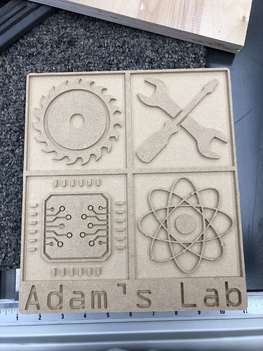

OK, first carve. I think it went well, learned some lessons along the way. It’s not perfect, but not bad. I took my time during assembly to make sure the frame and everything else was square, but the machine is still sitting on my shop floor (which is most definitely not level). I need to build a proper stand.

Looks good.
Seee…
It’s all worth it isnt it?
Nice work.
And just think, you have many more coming.
