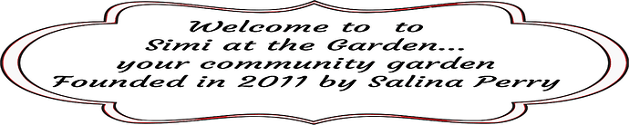

Tiling works, it is best to do a dry test for lining it up I was off a micro bit had to sand way too much to fix it but If I would of set it up better I could of avoided that. I did a 46" x 16" sign with vcarve desktop and tiles.

@PhilJohnson I am not sure how I would use the dowel pins, I was planing on using one piece 50" long and just sliding it through. @RobertCanning did you use a continuos piece? If so how did you lineup where the next point to start was?
I agree with Robert that Phil’s guide should be made a sticky. thanks again for all the help, this project has to wait till Monday. I am going jet skiing on the California delta for the next 4 days.
