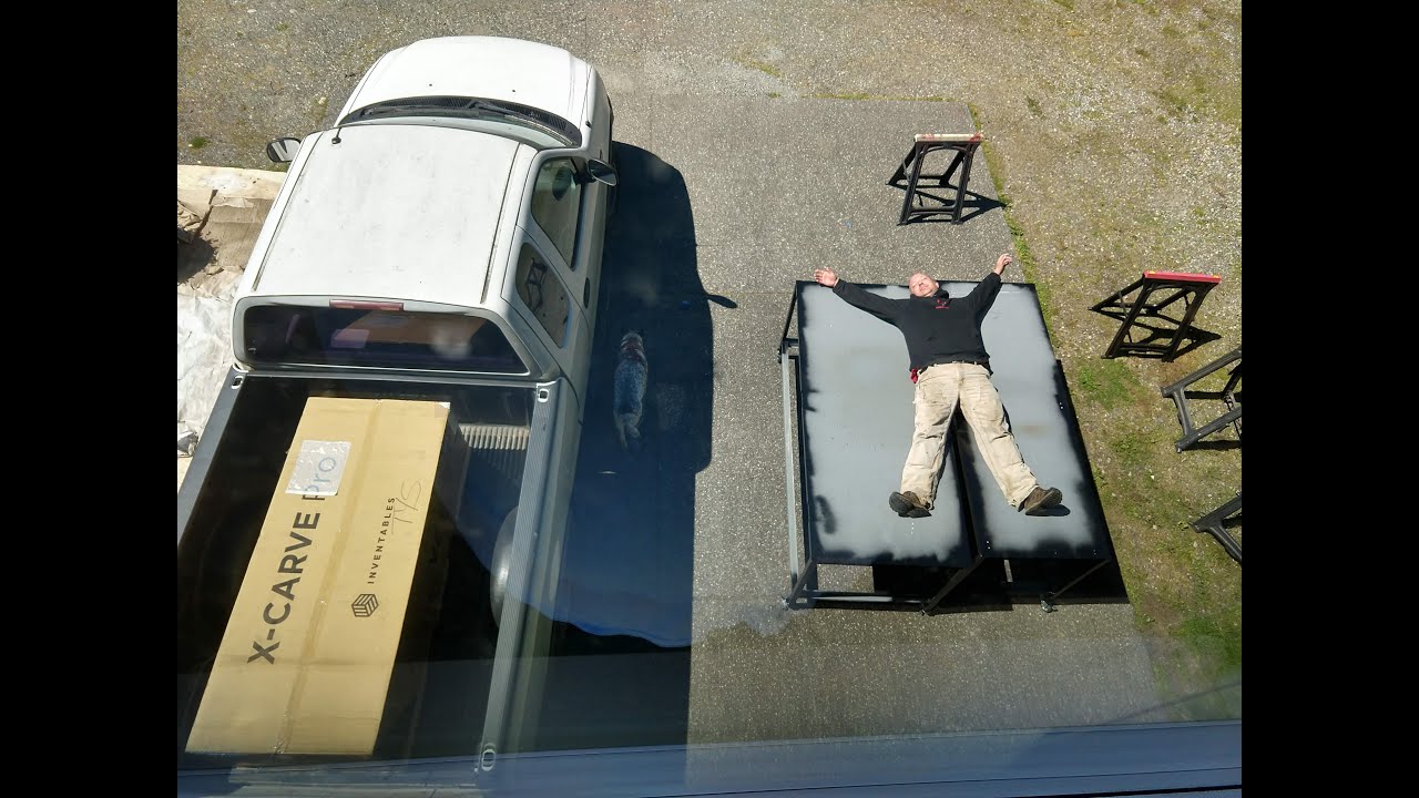

I had planned to build a nice table out of 4040 extrusions that would have been about the same cost as two of the uline tables but…
What I ended up doing was converting a couple discarded heavy duty steel doors into a pair of tables and attached them to each other. It’s not pretty but it’s been working fine so far.
Here’s the timelaps video of my X-Carve Pro table build if you’ve got a few minutes to kill!
