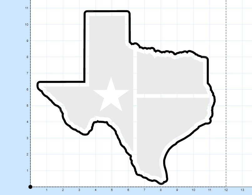

I’m still newish the having my own cnc machine, so I haven’t started doing anything 3D yet, or engravings. So I don’t know how useful your vectors will be for me particularly. I’d hate for you to go out of your way.
This is what i’ve come up with so far, i’ll be doing a few different combos of paint and stain.
All of my designing is through Easel, my running software is Mach 3.

Nice! I can’t wait to start doing inlays… which im assuming by the drawing you showed me, looks like the inner parts are inlays.
I think the way that I saw it initially, the inner areas were pocketed and painted to match the state flag.
Oh nice! Regardless though there’s some carving that has to be done it looks like. I haven’t done carves yet, really looking forward to getting VCarve though!
Just pockets. About 22 mins with a 1/8" bit. Feed 60ipm, Plunge 40ipm, DoC 0.0625" It’ll fit on a chunk of 1x12
I understand what you are saying, that’s just not what I was doing. I left a raised border and divider.
Gotcha, so i can do “pockets” without v carve then.
What tool path are you using for these?

Why so? I got the size of texas by overlapping it of a svg of the united states, and resized it till it fit.
Does it matter what type of bit for the pockets? All i have right now is 1/8" downcuts.
