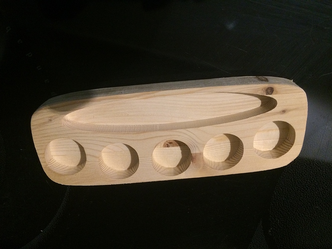

To finish I let you some picture of projects I’m working on or some experiment. Let me know if you have feedback to improve the X-Carve or my current project.
