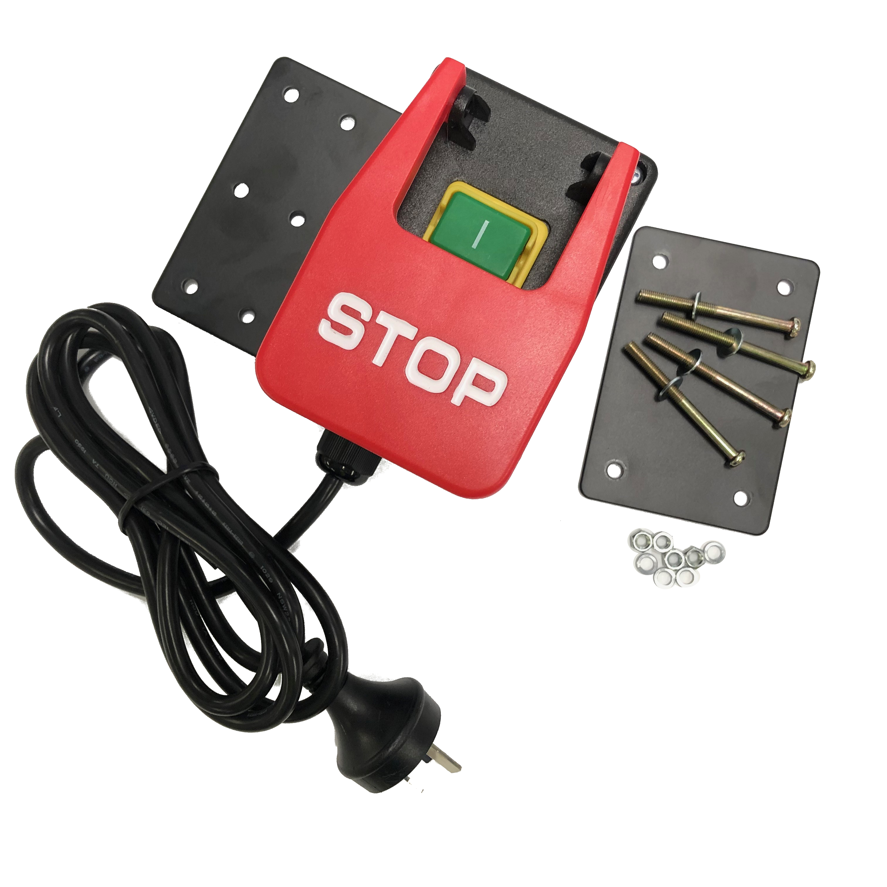

Hey mate, Iā€™m in the same boat with the neighbours and noise, my Cnc is in a basic shed so there isnā€™t insulation.
I built an enclosure and now Iā€™m considering chucking one of these nvr switches on the outside so you can just turn the router on and off before opening the lid.
That should help make silent when opening the doors.
Cheaper options available on eBay but my not be simply plug n play and would require you to cut the router cord.
Cheers
Cheapest option would be simple light switch and outlet with a little more from the local hardware store.
