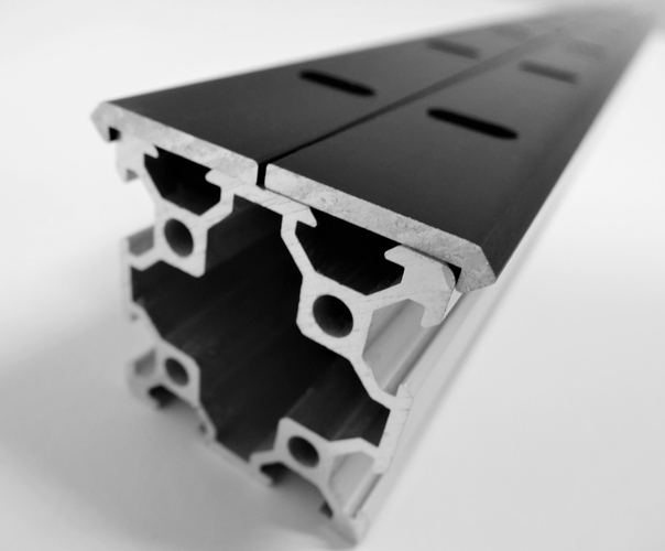

I mentioned this in another thread, but I was thinking of getting some 20x80 extrusion and drilling holes in the face to allow for bolting to slot nuts in the Y axis maker slide. This should add a lot of stiffness both for drop as well as torque. If there’s clearance you could bolt it so the 20x80 extrusion extends above the level of the maker slide to help block dust and chips from getting in the track. I was also thinking if done right it could allow for butting extra maker slides up to extend the Y axis beyond the 1800mm currently available. It might take quite a bit of work to get the joint of the maker slides aligned to prevent impact to the quality of the work, but it seems like it might work.

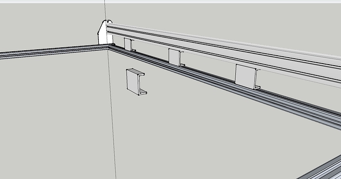

How about a piece of C channel aluminium? You’d need to move the lower rail out so it is directly under the MS. Getting C channel with the right dimensions might be a problem but the brackets could be machined from a solid block
The only problem with that is the lower rail has 2 attachment points for the wasteboard, and on the left side the drag chain attachment is in the way. You could buy 2 extra rail pieces and attach them, but you’d have to cut some notches for the drag chain rail.
You’d only have 1/4" to attach it also, since the v-wheels and screws protrude over the slot.

At the risk of being a dumb question, does it make a difference where you drill the holes through the Makerslide for the X-axis mod? Line A or line B on the attached diagram.
I figure Line A would mean more holes but I could use smaller bolts that wouldn’t protrude out far enough to affect x carriage movement plus the stepper wire could still be run through the centre of the MS.
Please let me know if I’m over thinking this, I’ve been breathing MDF dust all day. :grinning:
Brilliant! I’ll be implementing that soon. Thanks for the share.
I chose B since the bolt and nut heads were large, so they would be fully engaged with the aluminum instead of only contacting on either side of the slot.
Going through both A marks would be good if the bolts don’t interfere with anything, and if you can figure out how to get a decent sized bolt and nut buried in the slot. I torqued the heck out of mine, and would have damaged anything that used the standard M5 slot nuts.
Could go either way. If you want ultimate stiffness, A may be the way to go. I think that may be beyond the point of diminishing returns though, since you’d spend more time and do more work to stiffen up something far beyond the accuracy the of the rest of the machine.
I think for stiffness staggering from the top A to the bottom A would be best.
To deal with interference you could use a flat head machine screw, counter sink the heads and if you want to get crazy, tap the backside. This way you would really have anything sticking out!
My plan is to put 6mm dowel pins in position A and 5mm socket head cap screws at position B.
This will have to be done in a milling machine to keep the alignment correct.
This should give me the best of both worlds.
Dave
