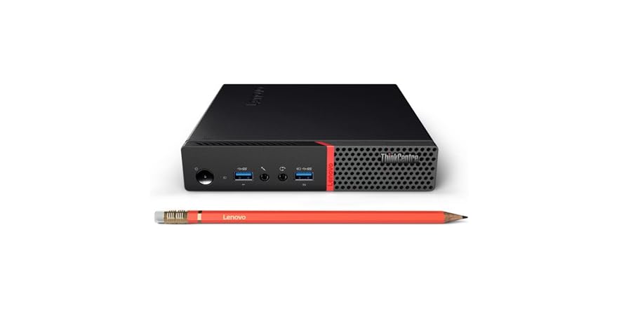

If you hurry this should be a decent deal…
