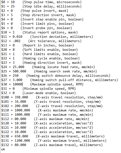

Hey hope this is what you were meaning. This is my settings a saved on a text document. They are all the same except i changed the $30 to 10000 for thats whats on my machine now.
Oh yeah, that’s the main reason I had asked for them, to See $30, 31 and 32. Which all look okay…
So before in the original post you had said you sent the commands “M3 S1000” this would cause a 10% of max spindle rpm. And the “M3 S18000” (or rather any S value 10,000 or above) would cause a 100% of max RPM.
IF the max RPM’s are a value other than 10,000 then I suggest changing $30 to reflect the Spindle’s Max RPM value. And using the correct S Values that align to this.

Side Note about the grbl settings shown in your chart: there’s no Max Plunge-Rate set ($112), so the Z axis likely has never moved unless that’s a typo… and the acceleration values seem very slow ($120,121,122) you can probably increase these to get some faster movement.
