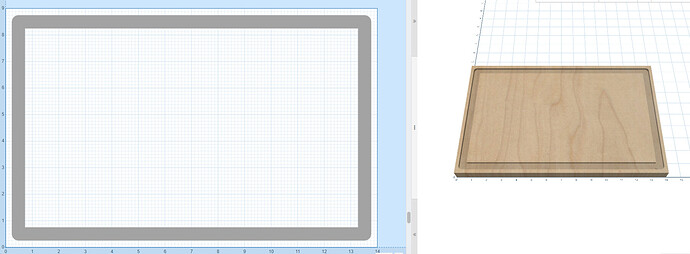

Uneven size on on wood even though perfect on easel
I am trying to cut a juice groove for a cutting board using a 1/2 corebox bit, but when I do cut it it looks
nothing like the easel image. I feels like the frame of the juice groove had shifted a tiny bit to up and left
Looks like your board was not at where the “Home” location is.
Home your machine first. I found out on mine that the grid on the spoil board did not line up with what I thought was my home position. Adjusted the board to the proper position and problem was solved.
Also make sure the board is exactly the same size as what you entered. Second look at your picture reveals this…
