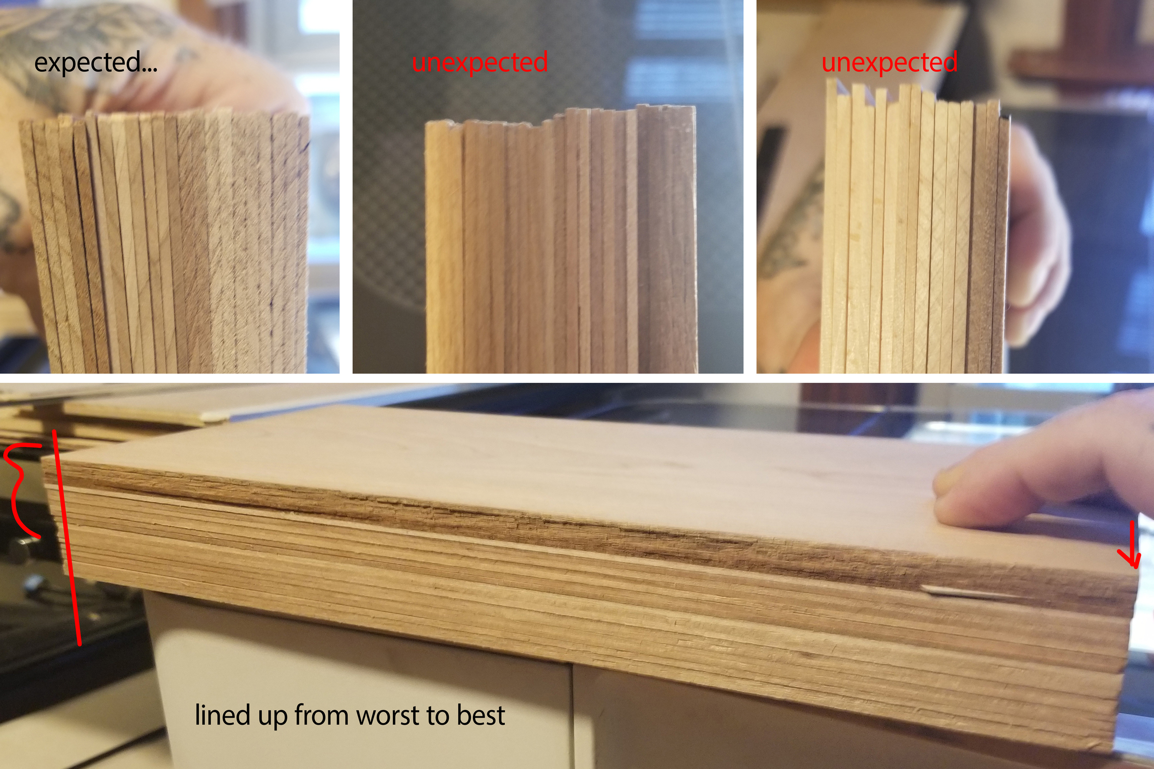

Consider these: all of which are “supposed” to be 6x12 by 1/16th inch thick wood
Next, consider that the order consisted of 60 (30 maple and 30 cherry)
and that the work time on the table is about 3 hours for 3 boards at a time.
Because each of these pieces of wood are anywhere from 1/32nd to as much as 1/4th (+/-) each time a run is done I need to double check and create a test, then re-align the job and jig depending on how far off they are. Ended up having to make 3 different “spacers” to make em fit properly. Really increased the product time and slowed down the process.
Me and my client both laughed when we realized why all our cuts were all off on the 2nd and 3rd boards, we said “Must have been a shift change! lol. the guys that cut ON the line are gone for the day and the other guys who cut NEXT to the line finished their run”
Fine, so be it. Humans did it, I get it. But… now “measure twice cut once” has become measure 60 times and make new jigs, then change the artwork out and double check the board alignment.
I kind of feel like these should be "6x12 - 1/16th with LESS than 1/32nd of a variance… Anyway - the following series of thoughts come to mind, some of which are questions:

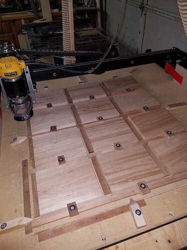

Hi Christian, I do some production work on precise pieces as well. To eliminate inconsistencies in the wood blanks, I make my fixtures so that each piece of wood is referenced independently. Here is an example.
This fixture can hold 12 pieces on my 1000x1000. Each piece is referenced to the lower left corner. To make the fixture, I first constructed it as close to square as possible, but each pocket was intentionally undersized slightly. Then I did a final trim with the x-carve to flatten the bottom of each pocket and cut them to the exact size, which makes them perfectly square to my x-carve, as well as knowing the exact position of each pocket relative to machine home. Now I just need to load up the blanks, and reference the carve for each piece to the known location on the fixture.
Hope this helps.

what I see in your photo is… to me… horrific… and impressive. LOL
Its impressive in the sense of “wow, nice work man!”
I am however horrified at the prospect of “engineering my own materials, before engineering a final product”
Ergo: I feel like the whole point of sourcing “ready materials” is to save time by using materials… that are ready.
On some level though… I have started to think that I might as well grab a Husqvarna and start sourcing trees since I am so picky.
