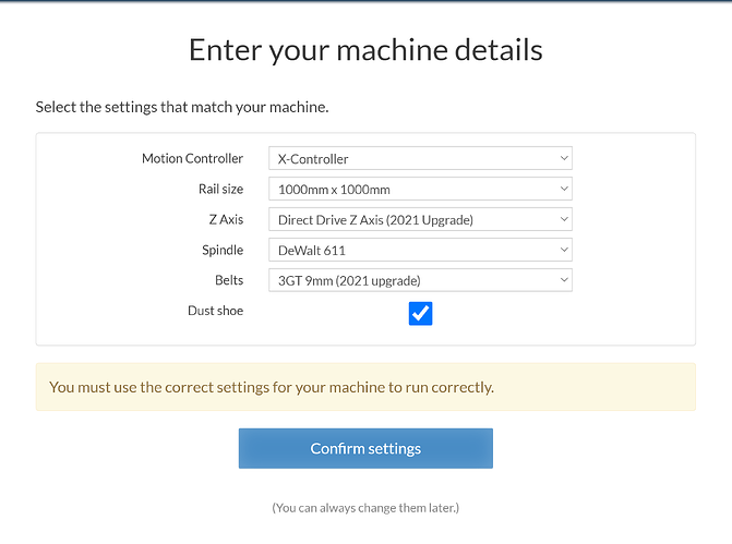

Reading through the instructions for the Z axis I am confused about the $3 setting.
Because the stepper for the Z is no longer upside down you need to adjust your $3 setting to invert the stepper (before it would rotate clockwise to lift, now it will need to rotate counterclockwise to lift) You will want to read your current $3 value and adjust per this chart so that If Z was “Y” it will now be “N”… OR if Z was “N” it will now be “Y”… rather than making a blind change like the manual says to do, its better to read the current value and then modify based on that… Also some people have reported plug and play for the $3 which indicates that the 2 motors were wired inversely, which is actually quite common. Here’s that Chart:
Ohh, that’s better. I’m still opposed to a program changing any grbl settings without making it a require the user to opt in to the software changing the settings…
BUT the addition of the upgrades to that screen are a nice improvement vs having to manually change these back after the machine setup…
Hopefully my video pointing this out this option missing when the upgrades were first released was taken in stride as constructive criticism and not as an outright bash of the initial oversight
