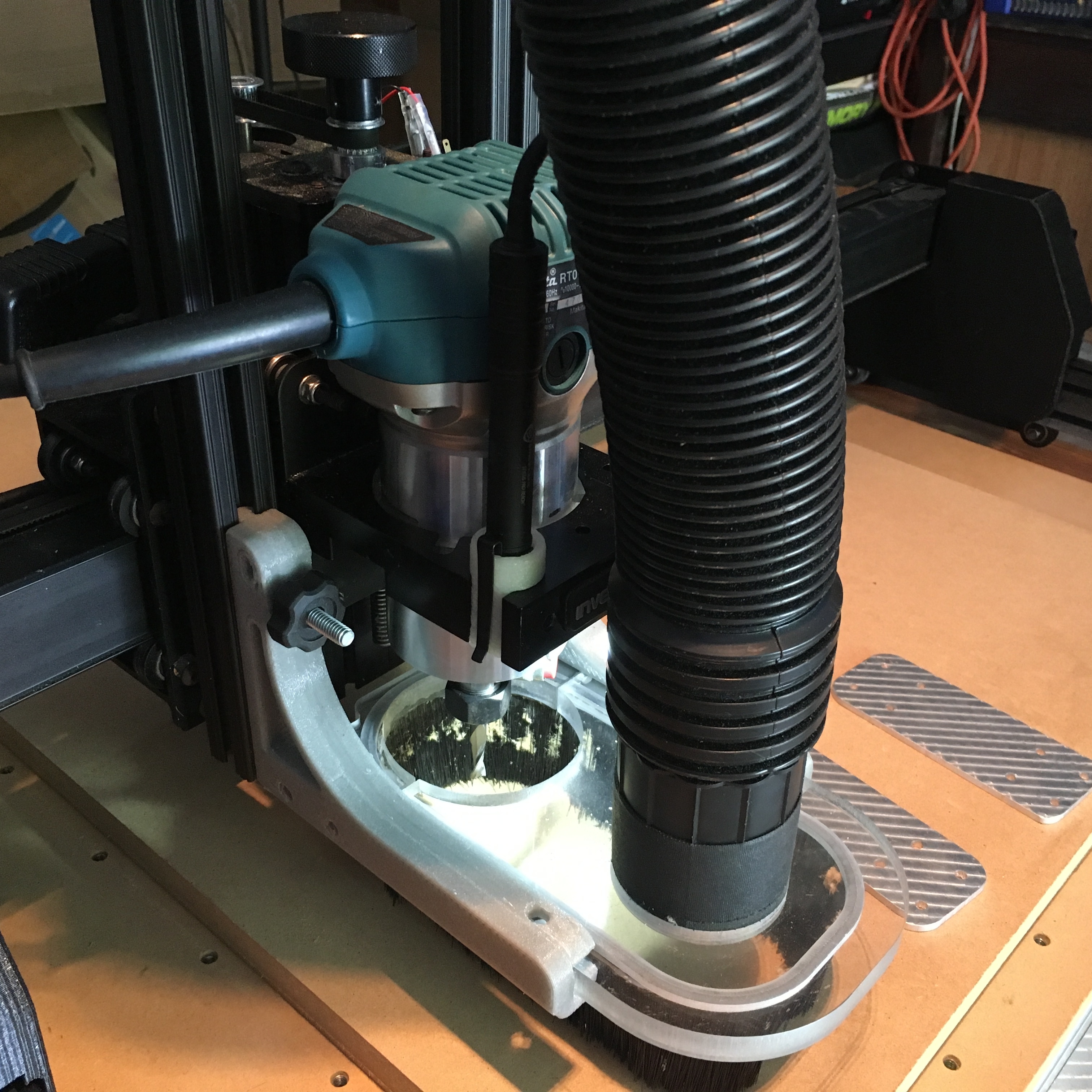

6" Linear Z on the way http://r.ebay.com/X56F4L . I’m designing some taller Y plates that mount to my new 40x40 base too. I’m waiting to receive the Z so I can measure much I can raise my setup (makita router, bosch colt mount, universal z plate). How much are yall lifting these with a linear z?

Pics or it didn’t happen. This is my setup, I customized Phil’s dust shoe for the colt mount, thanks for posting those .stp files!

I installed the linear rail and used it to cut my new Y plates (.3" thick). I got a huge 1/4" and a 5/16" aluminum plate from the metal scrap yard for $8. I also cut a bracket to strap the top of the linear rail to the 1x1 extrusion for Phil’s dust boot. Good thing I left them long! Motors coming tomorrow. Thanks for all the advice.
