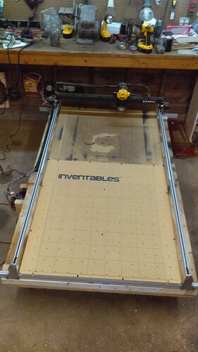

Upscaled my x carve with 1800mm makerslide and taller thicker endplates
Upscaled my x carve with 1800mm makerslide and taller thicker endplates I cut with the original setup. It can now carve up to 64 inches x 31 inches x 4 inches tall.
Looks good. I have the same plans in mind when I get mine.
